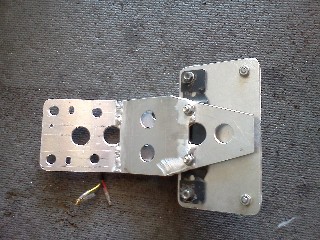

After buying two edge II rear brake light assemblies and repairing the plastic, I replaced the plastic piece with something a little more durable. Replacements were caused by a bike loading incident and a nice loop out, brain fade induced.

Which one is that? Doesn't look like the one for the KLX. I have it on my bike and it does not have that reinforcement section behind the tail light. Or did you solder it yourself? Just curious.

Soldered it up and mounted up in a couple hours. Then backed up the license plate with .125" aluminum to prevent any further bending.
I wanted the edge II light since it had more support for the license plate than the other kit, but the plastic is not crash proof.
