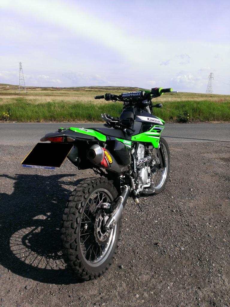

I went with the oxford mini led indicators, no resistors needed. I just clipped off the odd indicators and soldered the new led's in.
I could get a pic if that helps at all.

These indicators
http://www.ebay.co.uk/itm/like/11134...13=80&ff14=108
