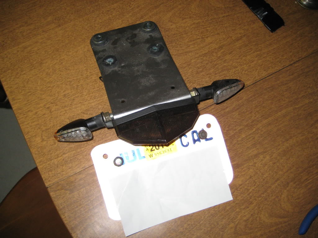

What it looked like before...

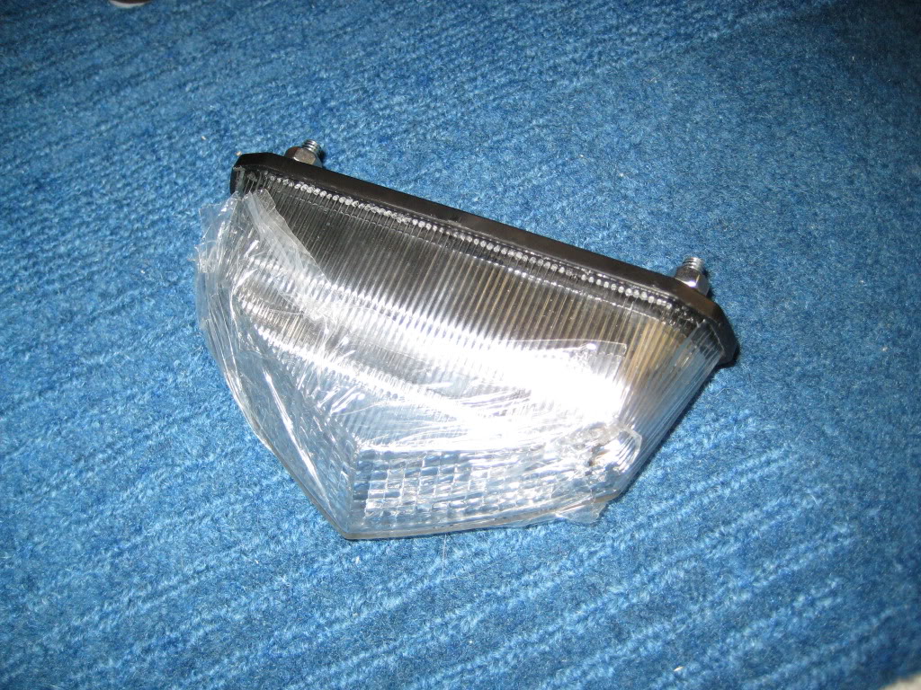

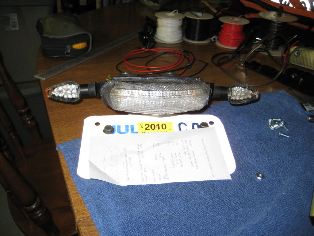

I bought this light off Ebay to gut and use to house my high intensity leds...It was also brighter than the Edge light, maybe because its not smoked?

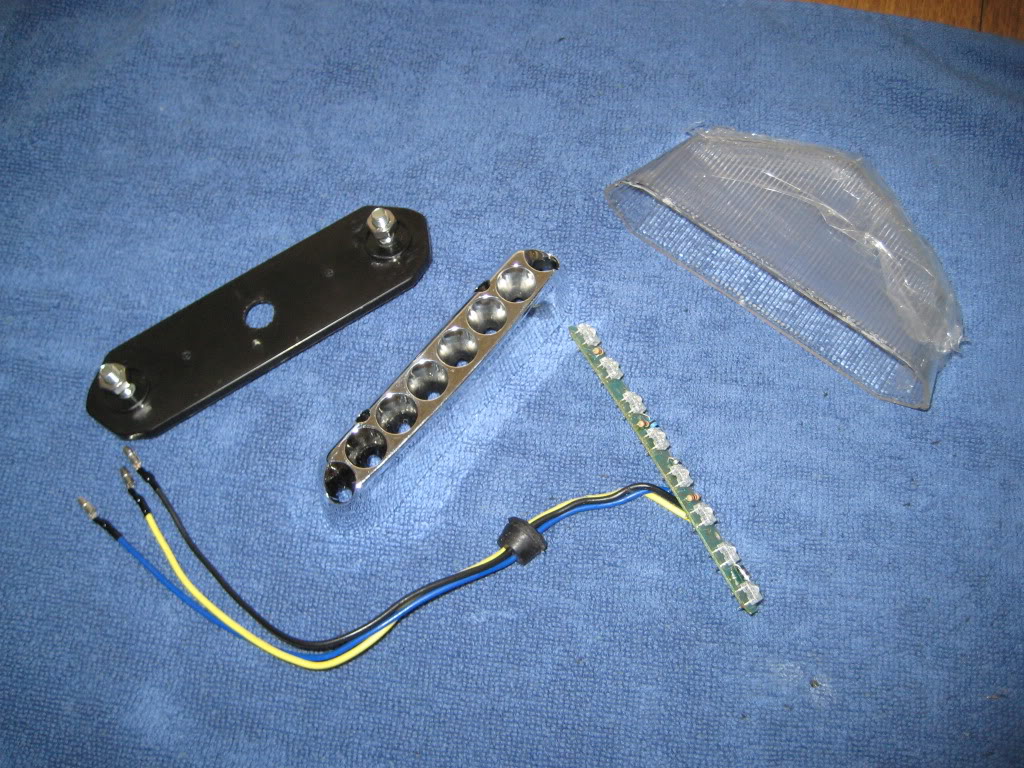

Donor lighthead guts

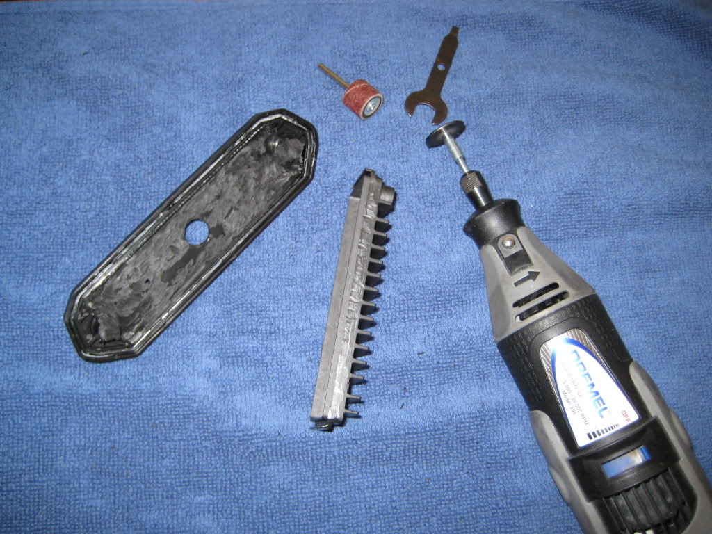

The led lighthead I need to trim down to fit into the above housing.

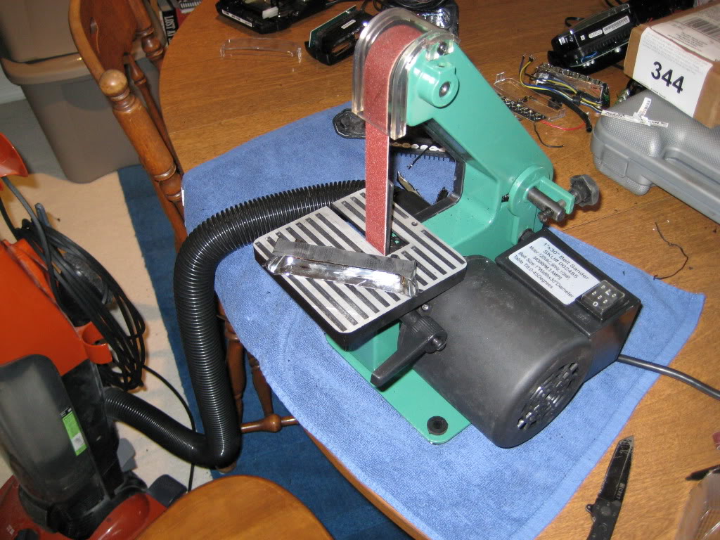

The trimming begins...

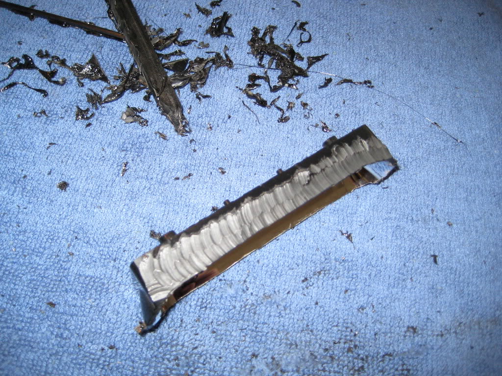

Still trimming and shaping...
Trimming the base of the donor lighthead...

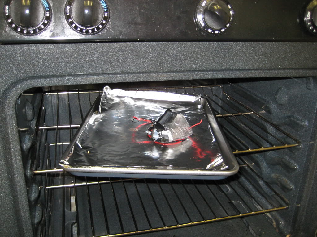

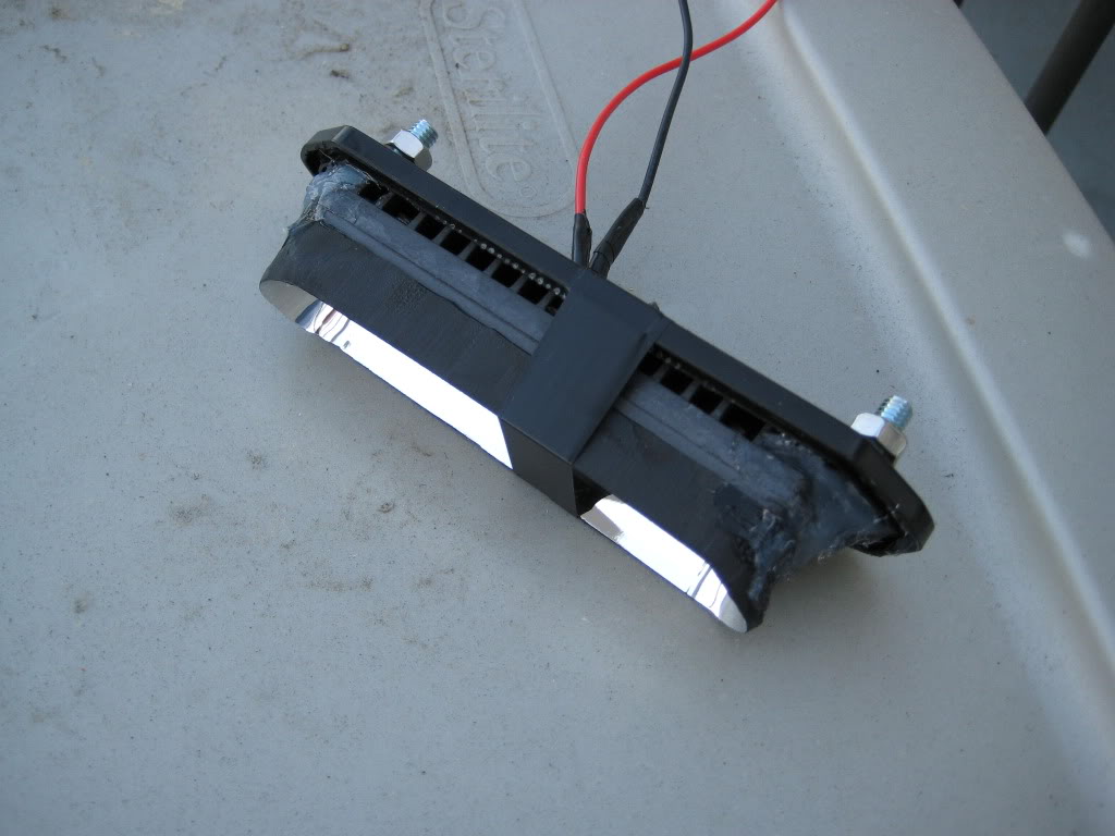

New lighthead installed into the new housing and put in the stove @ like 100 to 125 degrees to help the silicone cure faster.

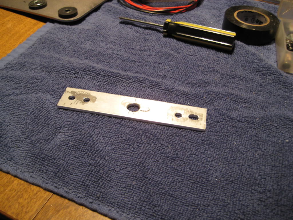

Bracket I made to accomodate the wider bolt pattern of the new lighthead...

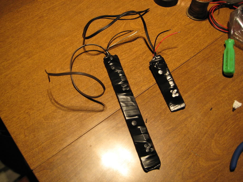

Led power supplies for tail/brake functions.

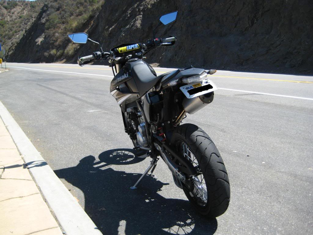

The finished product...

Still need to get that pic of it lit up...
