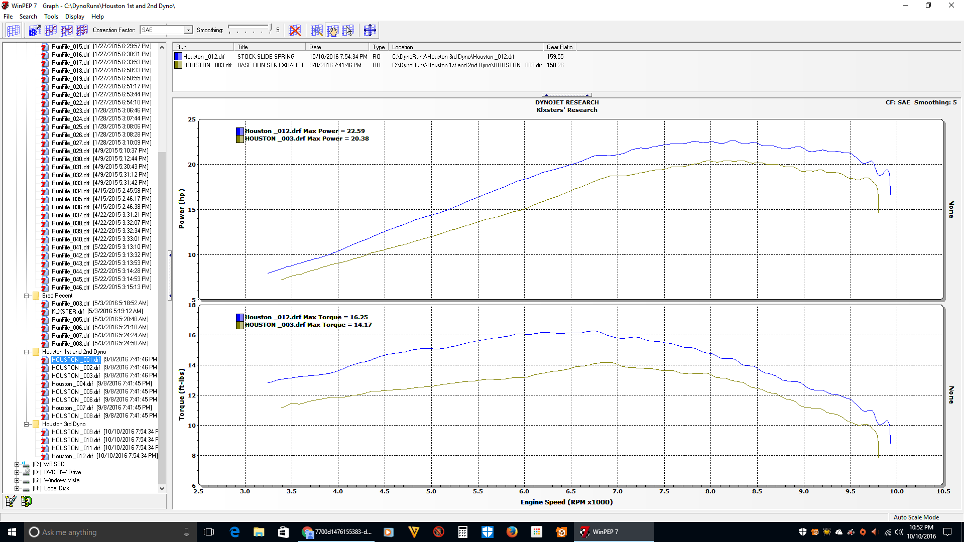

Green - 100% Stock 2013 KLX250S
Blue - Same bike, Lidless, DNO352 needle from DJ2206 kit, Clip on top notch (1N), DJ140 Main Jet, Stock Slide Lift Spring, Stock Header, Delkevic Slipon, #40 Pilot Jet
Clik on the image for best viewing..
The difference in performance is best described as "Extreme"..
