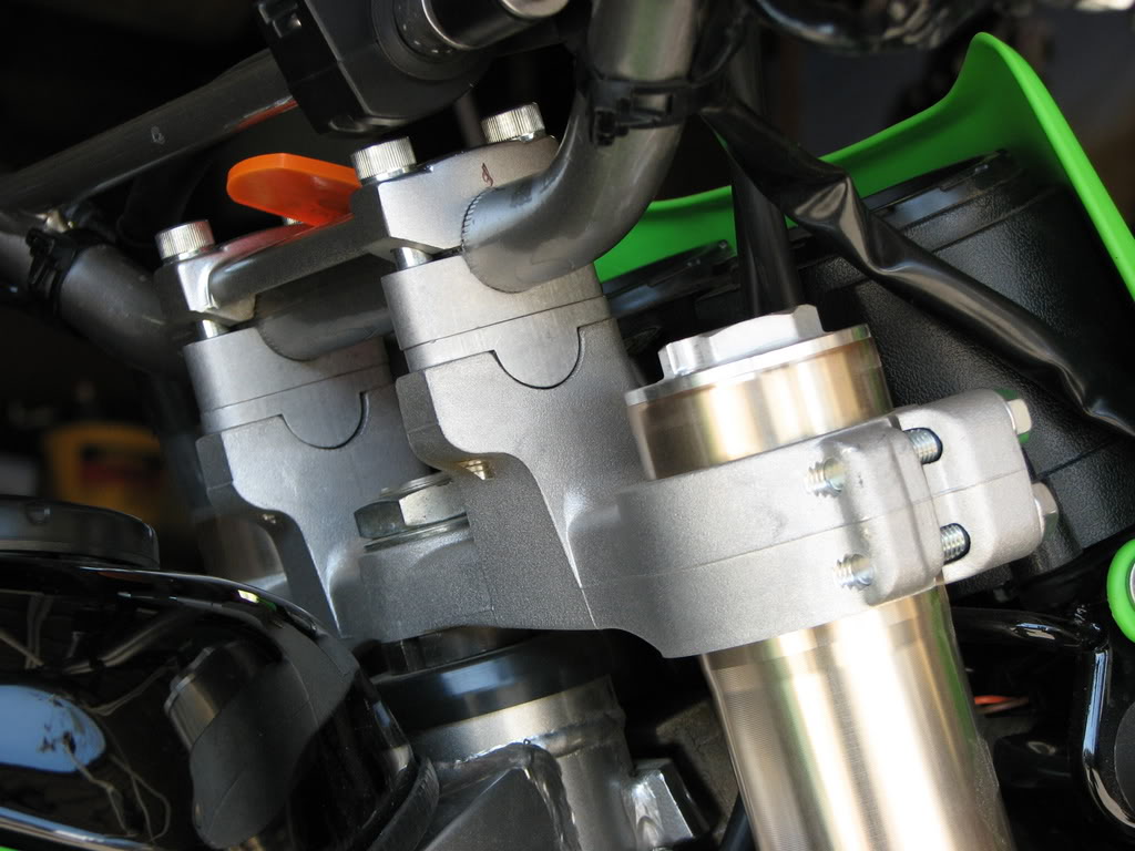

Lubed it up with some Moly-Lube and here are the results:
Code:
http://i167.photobucket.com/albums/u133/moles_photos/IMG_5672.jpg
I am really happy with the 1" drop using the Ebay dogbones, easy install and also installed a set of bar riser to offset the 3/4" drop on the front end.
Code:
<a href="http://photobucket.com" target="_blank"><img src="http://i167.photobucket.com/albums/u...s/IMG_5673.jpg" border="0" alt="Photo Sharing and Video Hosting at Photobucket"></a>
And thanks all for the help.....I f the photos dont post right I will have to back and learn somemore!

Moles last foto try!
