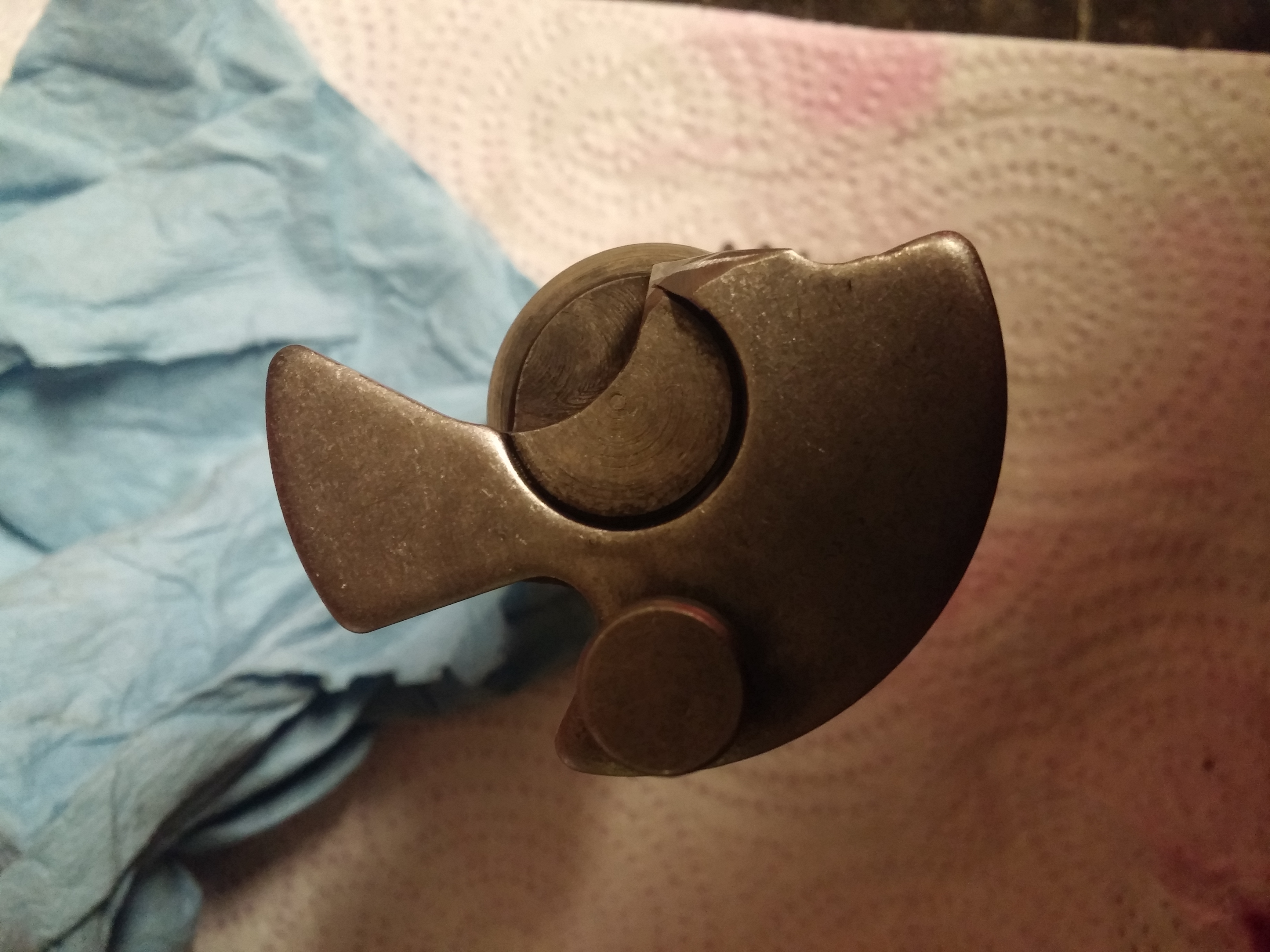

Well... here is where I'm at (see photo)
The KACR sucks... i hate it. Just trying to get the moving parts off cracked a "wing" of the KACR plate, since i wasnt going to put a big old crack back in there, I had to cut off the offending portion. I am passed the point of no return on removing it, which is what I wanted anyway.
My only question is should I cut the rest of it off or just leave it. Pressing it out is really not an option because I dont trust anyone around here to do it without damaging the cam honestly. The cam and gear are so fragile that I dont think you can do it without making a custom holder, and no shop is going to do that. I dont see any issue running it as is except for any imbalance it may cause, but the cam is already not balanced and whats remaining cant weight that much

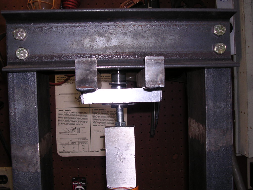

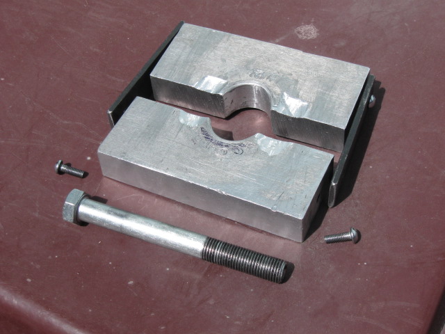

A clamp is easy to make. Here's the one I made before I got a mill and it in action.

What surface of the cam are you clamping it onto? cant tell in the pic. Are you bolting it to the bearing surface just below the gear? I was trying to avoid that area...
Old May 10, 2017 | 10:34 PM
Brewster's Avatar
Joined: Feb 2009
Posts: 667
From: Hayward, CA
The clamp is just above the mounting ears for the cam gear. I've done over 150 ACR timing mods with no damage to the cams. Please notice that there is a little material hogged out to make sure that no pressure is applied to the ears.

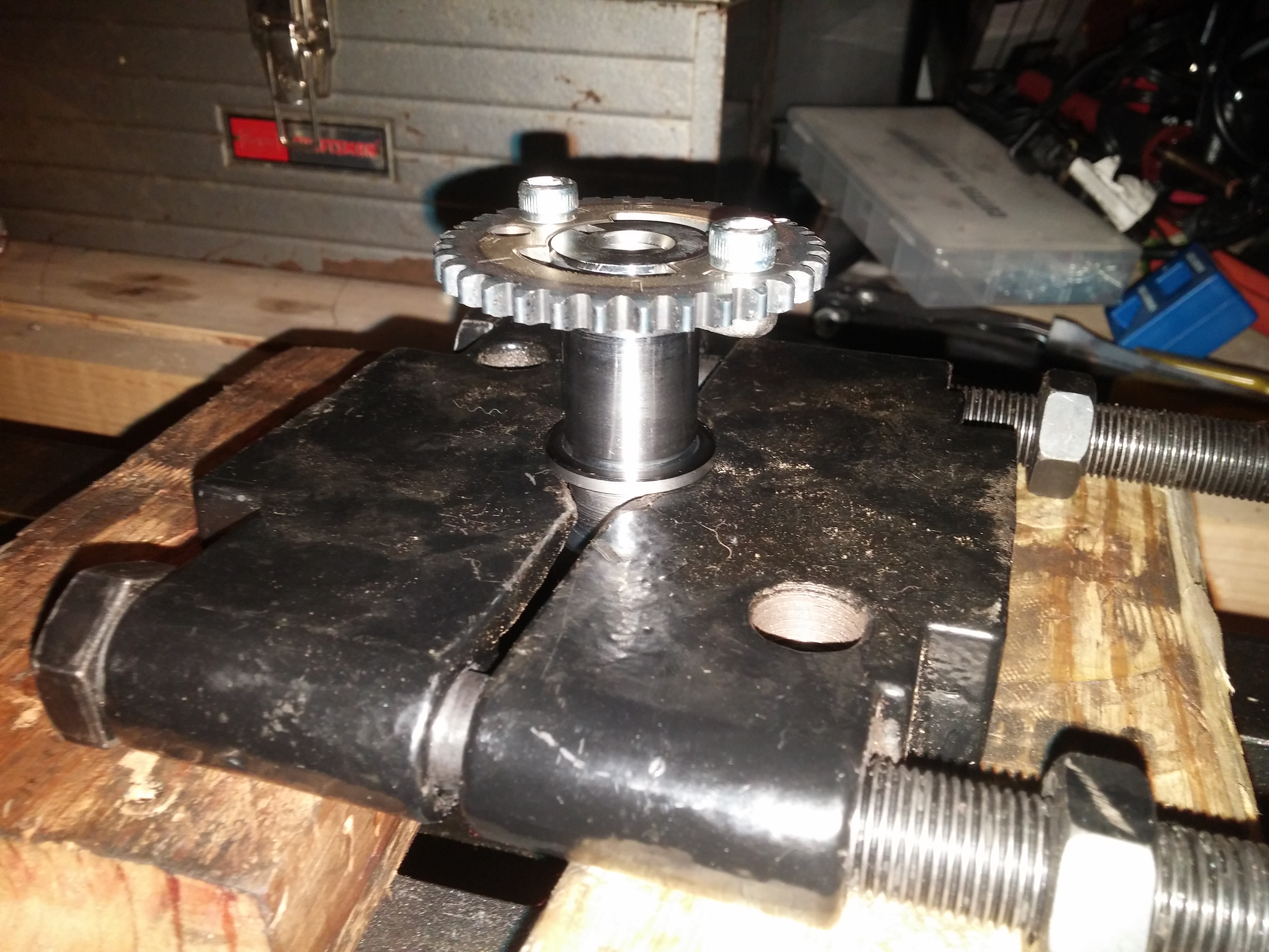

Dunno why I forgot I had this bearing splitter.... Doh. Thanks for the pics Brewster it reminded me I had it.
Large bearing splitter/puller from harbor freight, I'm sure a smaller one would work even better. Was able to press off the KACR with my 12T press (took a darn good bit of force, I was surprised). I braced it on the "lip" that must be the thrust bearing for the cam, Seema to have worked fine, I sun the cam in the head and could not detect any warping or damage
The KACR weighs a surprising amount!!!
