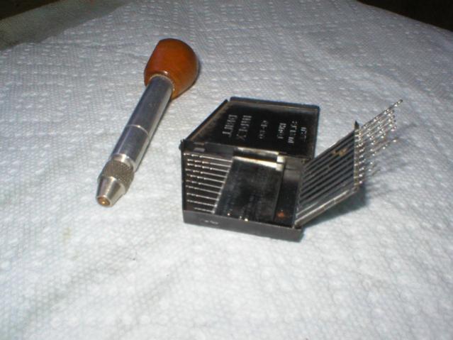

Drill the starter jet out with a .018" or .019" drill bit by hand and be done with all cold start problems no matter how long the bike sits.
