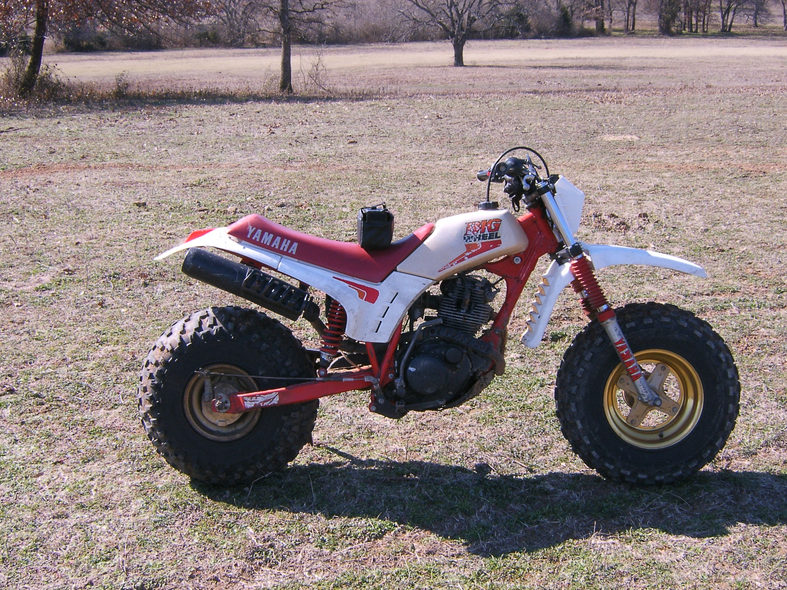

Having owned, from showroom new, a BW200E for over 20 years, I can say they are fantastic bikes with crazy capabilities.. I finally sold mine. All my kids had long since stopped riding it - preferring their KTM's - and it was just sitting year after year, AND, it was worth (and in fact sold for) way more than I paid for it in 1986 !
Here she is:
Here she is:
