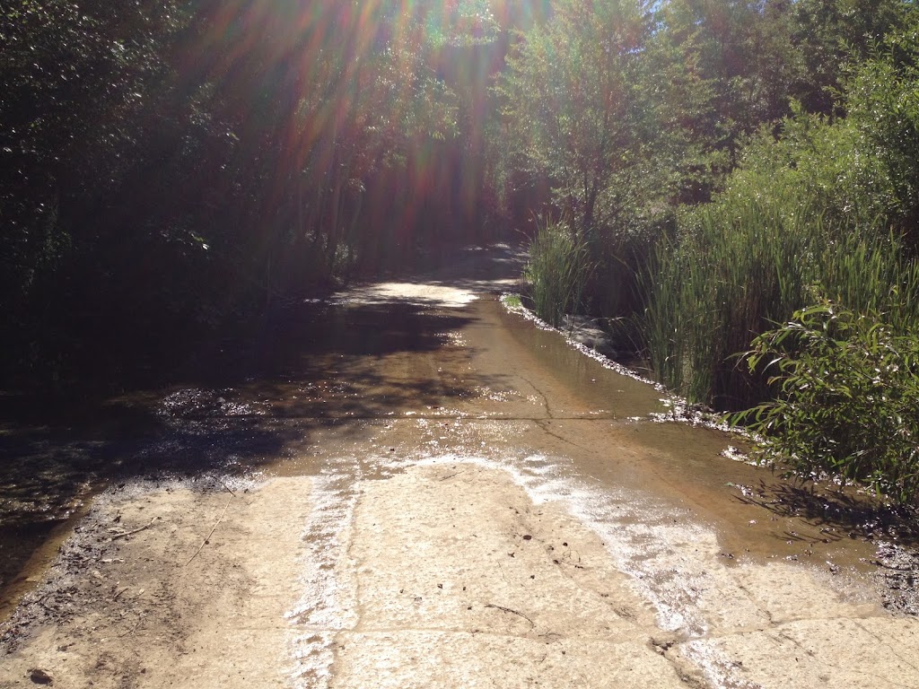

I know this is an annoying newbie question especially for a first post so sorry in advance, but I've been doing a lot of research this afternoon and I cant figure out what type of replacement bars to get for my 2012 KLX250S. I'm a new rider, only about 500 miles and I lost traction big time on a concrete river crossing that was covered in very slippery algae slime. The bike swapped ends on me and I was laying in the slimy stagnant water before I knew what happened. The 25 mile ride home through the twisties with bent bars was awesome . The bike was undamaged except for the bars and the clutch leaver.

By any chance, did you crash on one our "slicker than snot on a brass doorknob" concrete/natural rock water crpossingsa here in TX? They are extremely dangerous.
Same idea but in southern california. We have these raised poured concrete water crossings and they are definitely slicker than snot when the water level goes down in the summer.
