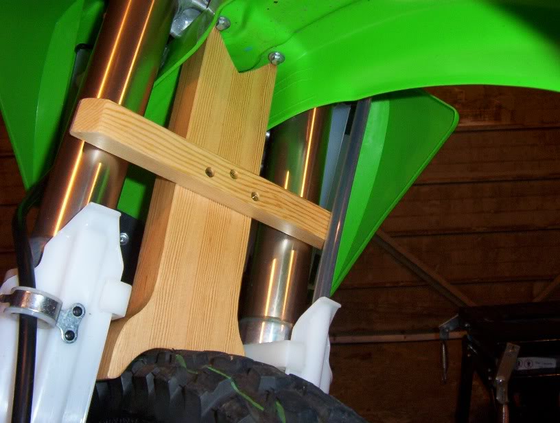

Look between my tire and fender, homemade jobbie. You can buy nice ones too.

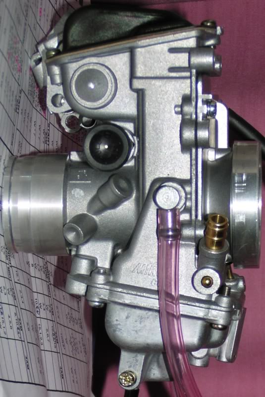

This will fix it if you don't mind spending a few hundred $

+ 1 on the fork brace. And like the guys said above, if the bike will sit for a few days then run the gas out. Just turn off the fuel 3 blocks before you pull into the driveway. Here is my Vampire fork brace I made a couple of years ago. Don't laugh. I was too cheap to buy one for $14.00 so I spent an hour making this one.
