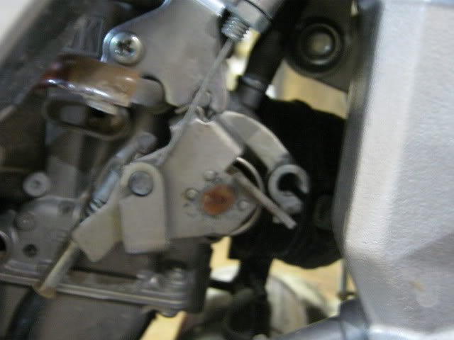

Before it does what mine did.
Sorry for the blurry pic. It's the bracket being held on by that single phillips screw. It locates on a little post (the cable passes right in front of it in the pic) cast in the carb, opposite the choke. The post broke, the bracket moved, and was binding against the bellcrank. I was able to get only half throttle.

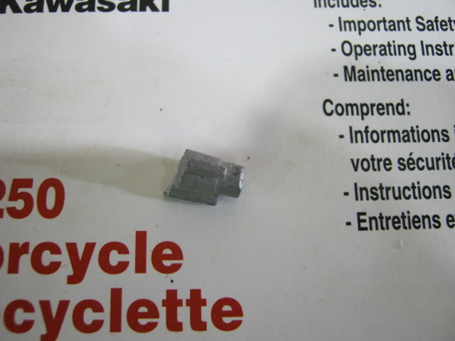

This is the piece that broke off.
I'm not sure why this happened, but I noticed something else when I was working on it. The boot from the air box was off the carb at the back. The best I can figure, is when I busted up my ankle last July, the bike came down on it in the side cover/air box area, and maybe the force pulled/jarred the boot from the carb. This allowed the carb to move, and the bracket to hit the head, and break the post.
I epoxied the post back on last night, added a piece of aluminum to the part the sits under that vac line (so it really can't move anyway), and used a socket cap screw that I was able to tighten a little better than that screw.
Anyway, have a look at yours, and make sure it's ok.

So I just got back from a few hours in the woods. This thing must have been loose since last year, preventing full throttle, and gradually getting worse. Holy cow, the bike feels like it's turbocharged now, and I don't think it's the new K&N filter I just put in

OMG! one of your throttle cables is MIA!
I have fought with that cheezy bracket that is screwed to the carb. It can be a bugger to get on just right and then get the phillips screw to catch properly.
