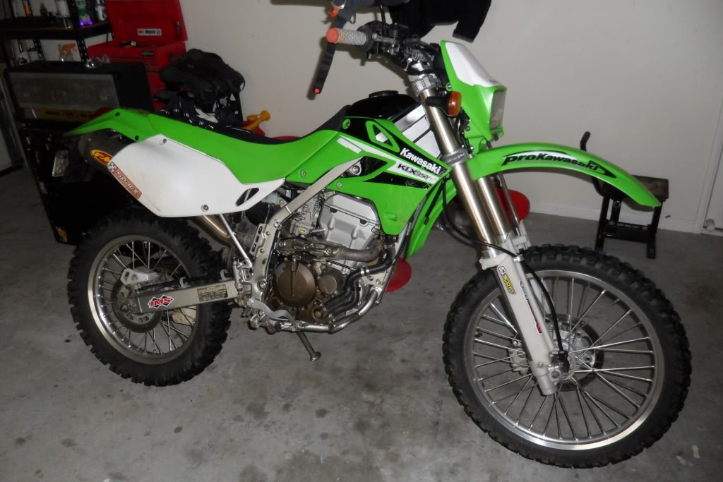

My bike....

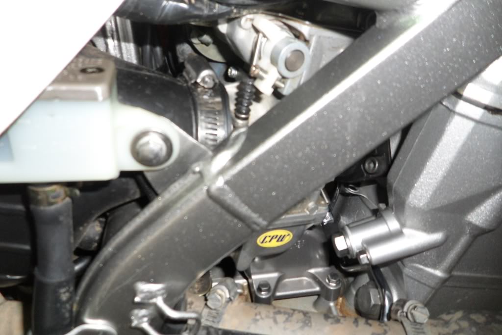

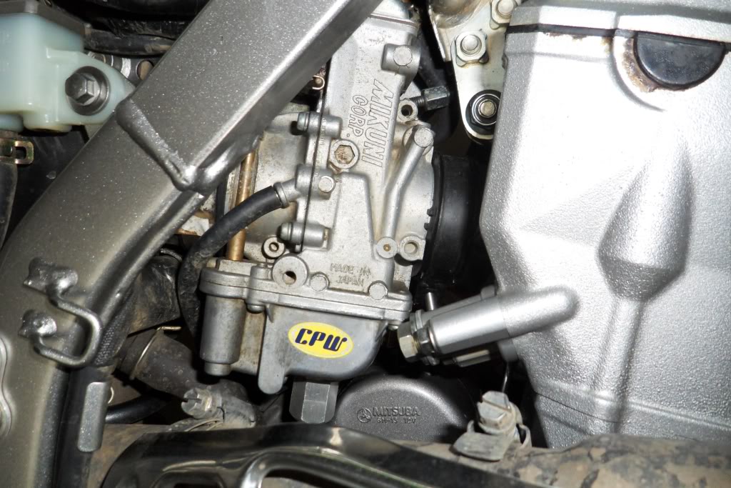

Carb from right hand side....

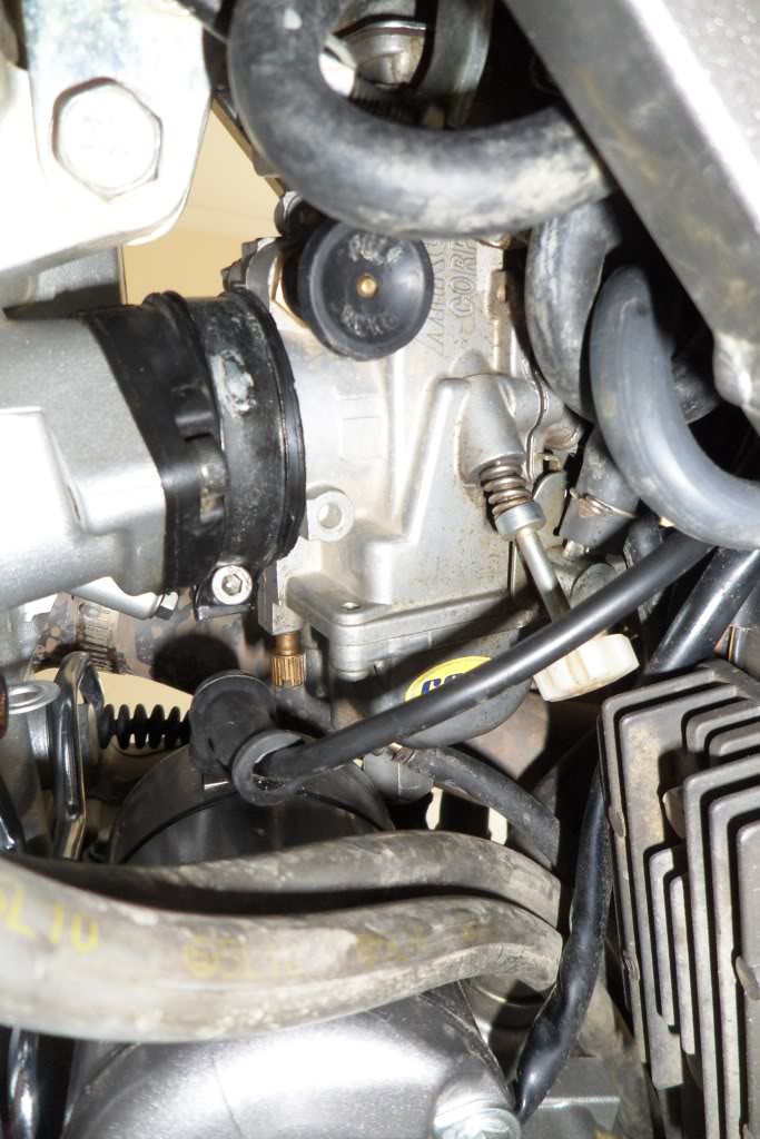

Carb from left hand side....

Bill Blue carb, on the right[intake] side you can see the part he made to make it fit the stock intake and air box boot. At the top is the cable holder he fabed.
Only has one cable, works fine. I had to move the wires out of the way.
From the top you can see the bracket he made.
