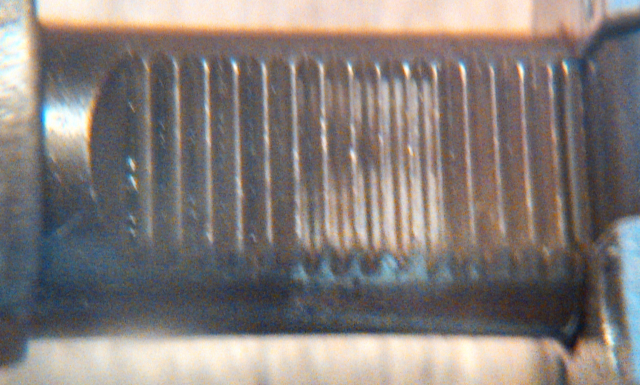

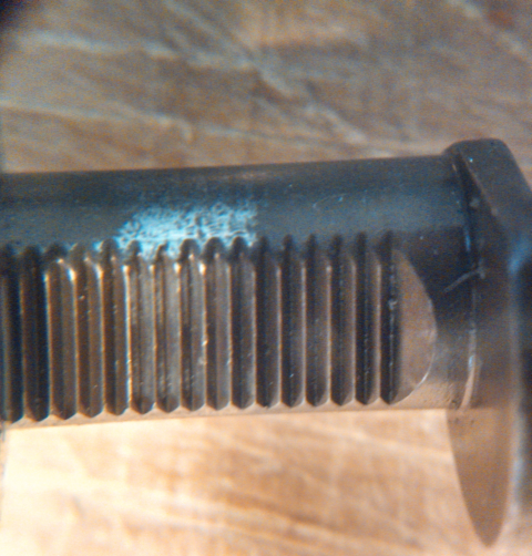

As for the tensioner, the damage is not readily apparent at a look. There is a tell tale wear pattern caused by the repeated kicking back and pushing out again of the plunger. I am attaching two pictures of my own 250 tensioner. The one tooth that is eleventh from the right shows a polished edge. That is because the tooth has been rounded. The pawl will also have similar polished edge. The back side shows polishing from the plunger sliding in and out on cam drive deceleration/acceleration.
Some will tell you there are some short cuts, like sticking a screwdriver in the tensioner and jamming it tighter to hook in a tooth further, or loosen the body until you hear it click over, but both are putting excess tension on the cam drive. With only a few thousandths of oil between the plain bearing cam journal in the head and the cam do you want to really make it tight? Adjusting a manual tensioner is easy enough to be far more accurate than either of those methods. The other thing with a manual tensioner is that you KNOW your cam drive is adjusted and will hold adjustment after adjusting per instructions and tightening the lock nut down good and tight.
I know a fair amount about this because of personal experience and seeing this damage on a number of other bikes like my KLX650, a tensioner from a ZX6RR, and a Suzuki GSF1250. I also have had other riders mention this wear pattern too. Does the tensioner work? Just ask here. Seems to be a weak spot on the bike.
Last paragraph pretty much true.
As for the tensioner, the damage is not readily apparent at a look. There is a tell tale wear pattern caused by the repeated kicking back and pushing out again of the plunger. I am attaching two pictures of my own 250 tensioner. The one tooth that is eleventh from the right the first picture, from the left in the second one shows a polished edge. That is because the tooth has been rounded. The pawl will also have similar polished edge. The back side shows polishing from the plunger sliding in and out on cam drive deceleration/acceleration.
Attached Thumbnails Cam mod clarification-mine5.jpg   Cam mod clarification-mine12.jpg

Awesome, appreciate the pictures. I wish I had taken a picture of mine but I did examine the teeth and they all looked pretty sharp, but I could be wrong. Maybe before I try the mcm again I'll get a manual one. Are the kreiger ones the go to ones for this bike?

To add to klx678's comments, I was getting an awful noise above approximately 7000 rpm. Sounded like a bent valve or a large gap.
I was running my original auto tensioner after getting a 300 kit and a new timing chain about 1100km ago. After some searching I found my manual tensioner (having moved house) and reinstalled that.
The back of the auto tensioner has a smooth area, not yet shiny, from movement. The teeth look good apart from an area that is cleaner than the surrounding areas.
If it wasn't raining as much today I'd be out 'testing' the adjustment. During the initial adjustment I was being cautious on the cam chain tension and it made that same clacking racket in the video almost exactly. I found that I had a few more turns to get it correctly adjusted. It's unnerving now not to have some kind of clatter but I'm going to have to learn to enjoy it.
