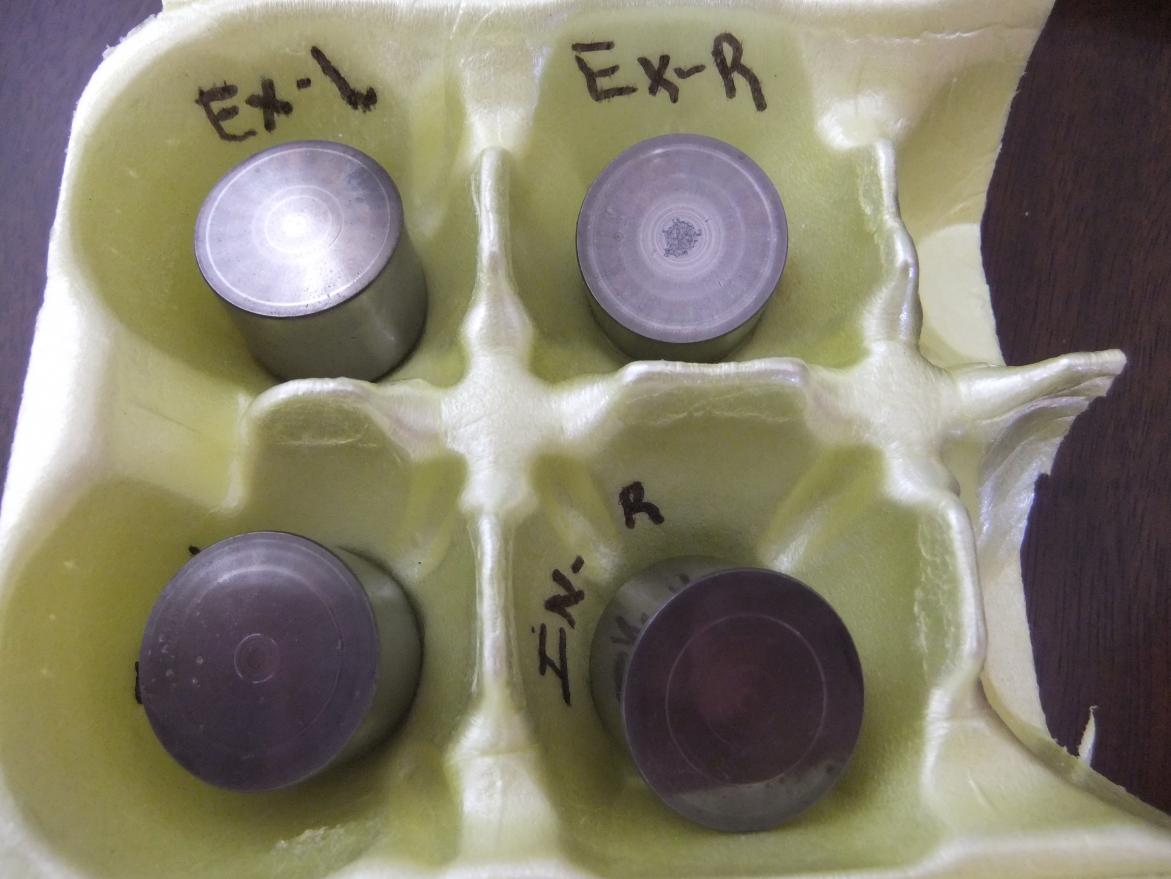

Pulled the valve cover today and checked the clearances before I started pulling everything apart. Everything checked out pretty decent for 6000 miles.
EX-L: 0.007'' EX-R: 0.006'' IN-L: 0.005 IN-R:0.006''

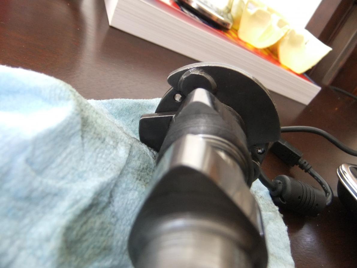

Pulled the cam cage and cams... everything inspected fine (those left side journals are undersized and it shows in the natural wear over the life of the bike as very light brush streaks show on the aluminum journals, my opinion at least).

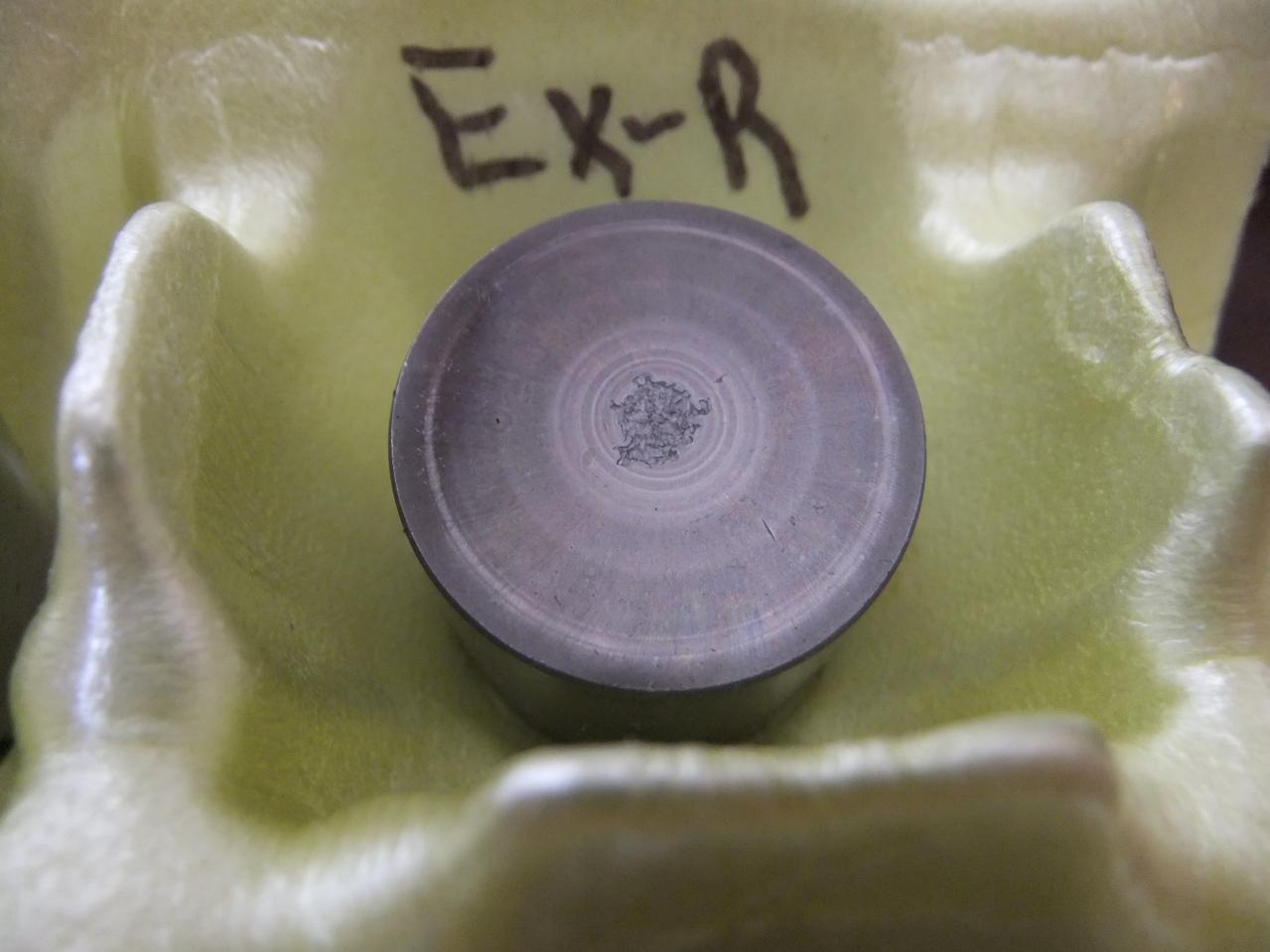

Anyways... the EX-R bucket had some pitting or watever you would call it in the very center of the bucket. The pitting is somewhat mild, catches the finger nail, I would approximate the the average surface deviation at thousandth or two maybe (just a guess obviously). Not sure why it is really there, the respective cam lobe is ever so slightly pointed in comparison to its partner, but it showed no scratching or anything else alarming as it was shiny smooth as would be expected.
Point is I will probably get new buckets ($25 a piece for oem from local powersports place... part number 12032-004) but before I do order them, I wanted to read the key board strokes of the experienced out here on this forum first.

Think it would be crazy to reuse the buckets with the new Webcams going in?
