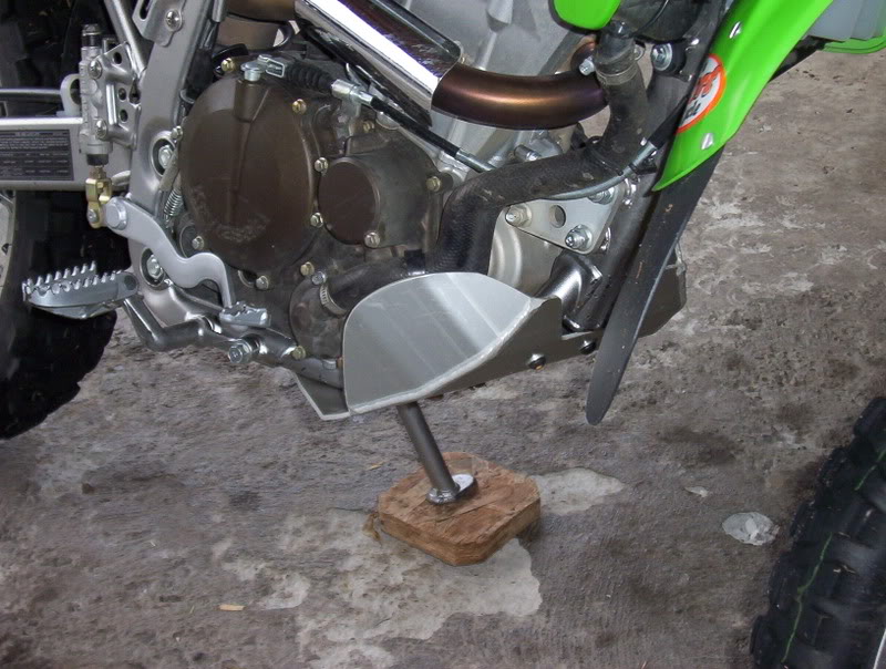

I've wondered about the durability of that pump and hoses hanging out down there. Makes me think one of these might be a worthy investment.
Old Jul 16, 2007 | 02:22 PM
Default RE: Broke it BAD!
I like the protection of the Utah skid plate.
