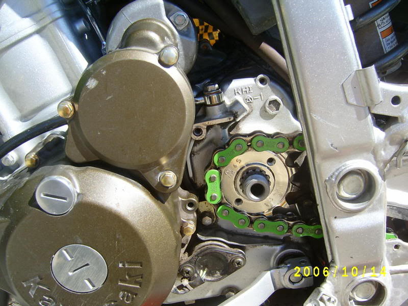

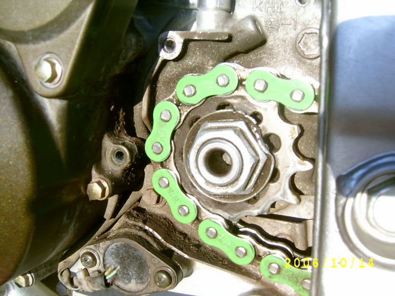

Okay sorry it took so long to post some of these pics. But have been a bit busy trying to get stuff done for the move. So here is some pics of the broken off teeth of my front sprocket..... If you notice in the close up shot of the new sprocket the lip is on the wrong side... it should be facing in... lucky I fixed it before I put the bolt on... LOL...
This is the old broken one
new one PBI45- 13 PRO
the install
close up... with the sprockt on inside out... I fixed it!!
Complete... Back out riding again... yeeppeeee!!!!
Take care all....
