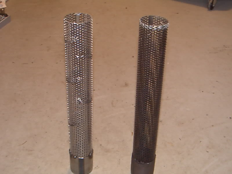

I thought the Evo package was supposed to come with a "Quiet Core" as well, but found out afterwards that it comes with the "Vortex Insert" instead.
Apparently, the part number just identifies that you are ordering a Quiet Core insert, but as some people have already found out, there are many Quiet Core sizes ... all of which have the same part number.
I took my Race Core insert out and measured all the dimensions, and included thesewhen I placed my order. Maybe I was just lucky, but the insert I received fit perfectly (well, with a little wiggling, but at leat no hammering was involved).
Apparently, the people who take the phone in orders are not aware of the various sizes, so you have totell them your dimensions- they won't ask you for them!!! (Big Gun does not provide "Customer Service", they only do "Customer Management", and they don't do it very well.)
Here is a picture of the "Quiet Core" on the left and the "Race Core" on the right (as show below, the exhaust flows from bottom to top):
This is a photo of the Vortex insert, that is used in conjunction with the Race Core (because of the baffles, it won't work with the Quiet Core):
Hope this helps.
Mike
