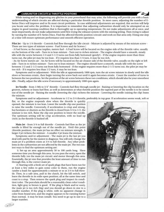

Dynojet kit 2206 (klx300R.) Stock pilot jet and a #128 main jet (Dynojet kit), needle on middle clip (Dynojet kit), Fuel screw set correctly (see addition below), and maybe fit a better flowing after market filter (K&N, UNI, TWINAIR.) Remove the snorkel at least.
