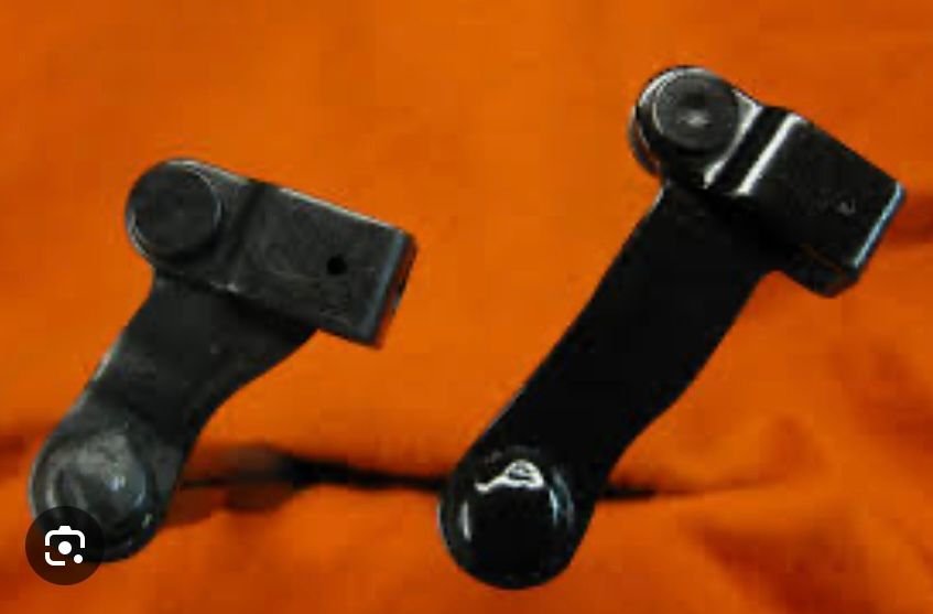

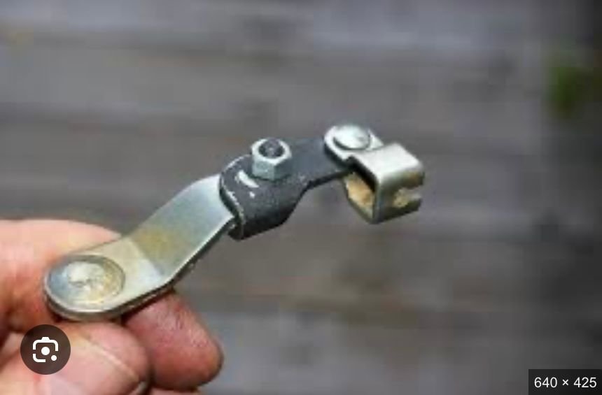

So I finally got around to extending the clutch pivot arm. Here's a few pictures of the extension. I added about 1/2 inch of steel to lengthen it. Then I had to cut and bend it for a better angle. I won't be able to test it for awhile as it's middle of winter here in Michigan. I'll post back in the spring when I get to test ride it.

wow looks good! I got one from Keng with my 355 kit. Otherwise I would also try to extend.

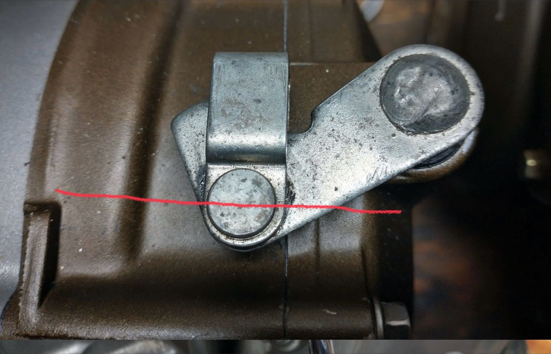

I can see why you had to do the last cut & reweld, Thanks for the pics and your engineering effort. I can figure that the pivot pin center line needs to be relocated when the arm is lengthened to land in between the lines I drew. The clutch cable inline adjustment will allow leeway. I’ll try using silicone bronze wire since it flows easier and makes me look like I know what I’m doing 😆
