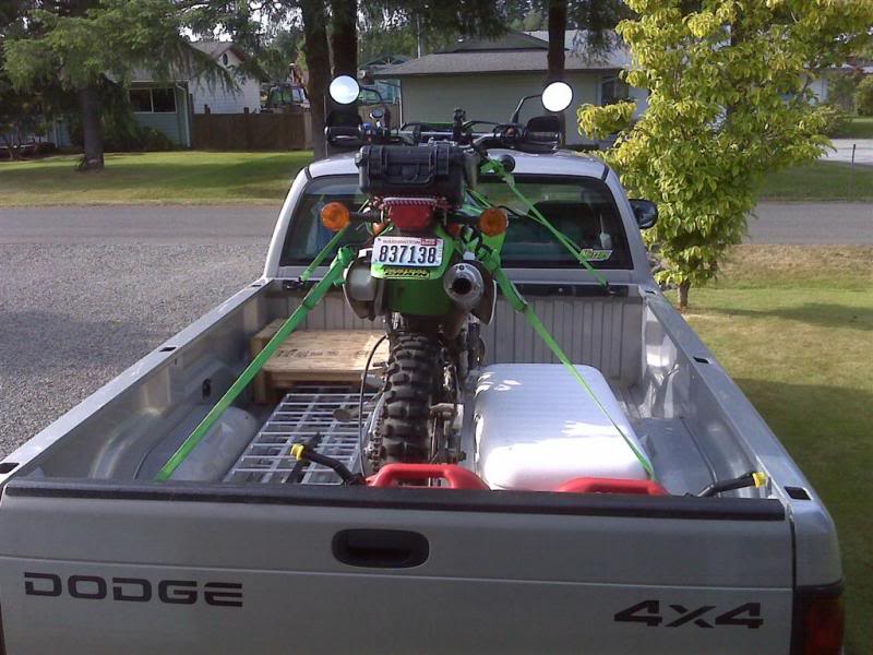

Here's the problem with a fork brace. It really keeps you from having the straps under a spring tension. I mean unless you have good ratchet straps, you just can't get it tight enough. Loading the springs half way down will not hurt the seals, and if I'm going a long distance I will use 4 straps 2 on the handlebars, and 2 on the rack back. It really locks it in. I also have a bar in the truck that allows 3 bikes to be loaded.
