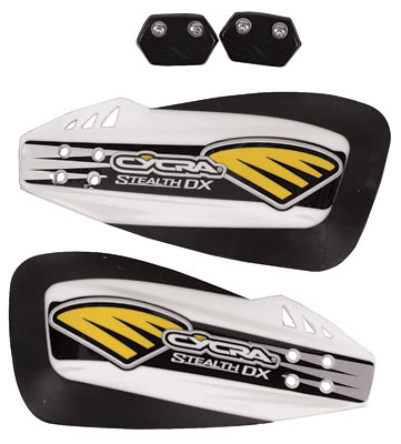

Cycra Stealth DX! We don't need no stinking barkbusters in the desert!
