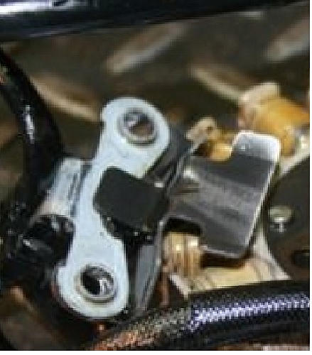

Well I'll have to see what develops with these two flywheels and the different timing they offer, though the stock timing unit is 1/2lb lighter. I could either get the advanced timing flywheel lightened or just have the welder add 3mm to the lighter unit.
Probably best to get the one that's on there now lightened, that way I'll have two lighter/equal weight flywheels; one with advanced timing.

There is a reason carb size gets smaller as more mid-low is needed. An example would be the old Bultaco 250, the Pursang (MX) had a 32mm, the Matador (enduro) had a 30mm and the Sherpa T (trials) had a 26mm.
This timing thing looks interesting. Question is if there is enough space to move the pick up or if any other flywheels will fit and give the increased advance?

The smaller carb = more low end power premise really isn't in question, maybe the 4 valve head helps in this application. Whichever, the amount of low end loss with the 40 isn't enough to worry about. Regardless of how big the number 40 looms.
Move the pick up either by slotting the mounting holes or slicing the bracket horizontally, moving half 3mm, then weld it back together?
Add timing to regain the small amount of lost low end with the 40mm?
