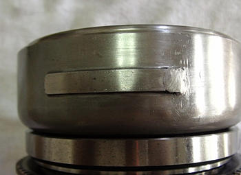

Well I got my flywheel back and whittled down the excess weld on top and each side going slowly. This flywheel is not lightened-just has a 3mm extension on the front of the rotor nose. The extended parts looks all ugly and lumpy in this hi-res photo, but it's not as bad as it looks; it's nice and smooth on top blending in with the original nose very nicely. Most important it's right on spec and it seems to be doing something.
The original length of the rotor's nose seemed to come out at 47mm, and this is 50mm, yielding the 3mm extension Bernie recommended.
