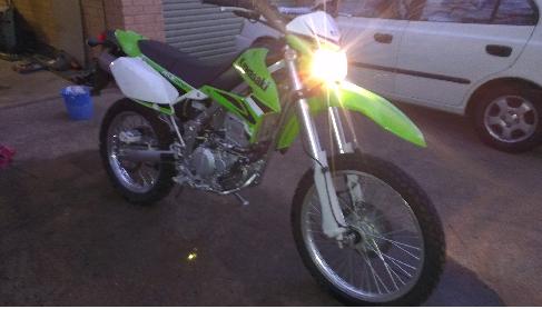

picked up the klx250s 09 a few months back, I was very stock standard

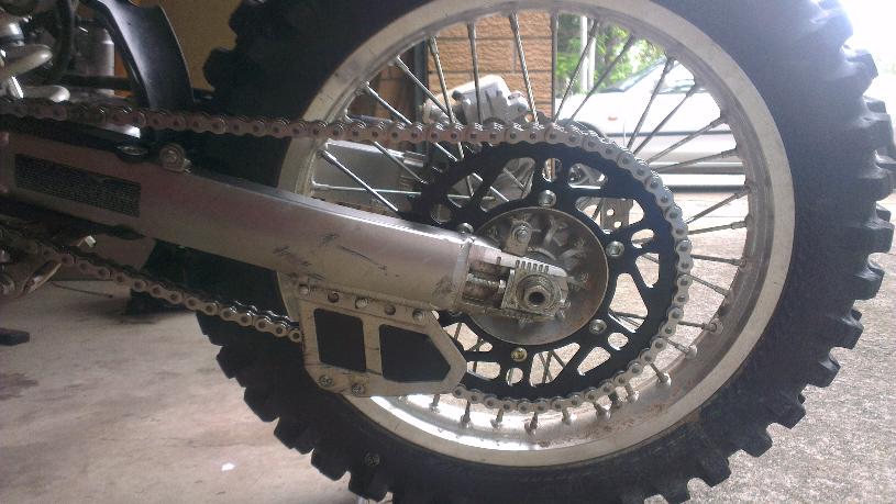

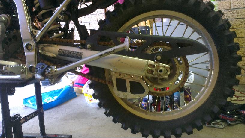

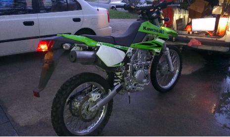

replaced 46t with 51T rear and 14T front soon will be replaced with 13T and new chain thanks to Moose racing (remember I mostly ride trails) I also have changed to a rear fender eliminator, LED tail light and indicators. spent some dollars on some chunky rubber ( these shred up logs!!!)
before:Beef up my KLX250s 09-46t-r-sproket.jpg after:Beef up my KLX250s 09-51t-r-sproket.jpgBeef up my KLX250s 09-new-fender.jpg

Joel: its the usual set up on off road. Currently running 14/51 much better for hills. If I do the 13 I would assume there won't be much of a first gear, but that will be perfect when stuck on a bumpy hill climb to get the wheel spinning and get me out of an uncle Rutt...

Wow 13/51t . Mine is 14/49 . I'm thinking 14/51 maybe ill try it this summer. Can you still do 65 mph on 14/51 ? Need that speed or close to that riding towards the trails. Tnx

Pogiboy - I've got 6 gears, she makes it easy with 14/51.
