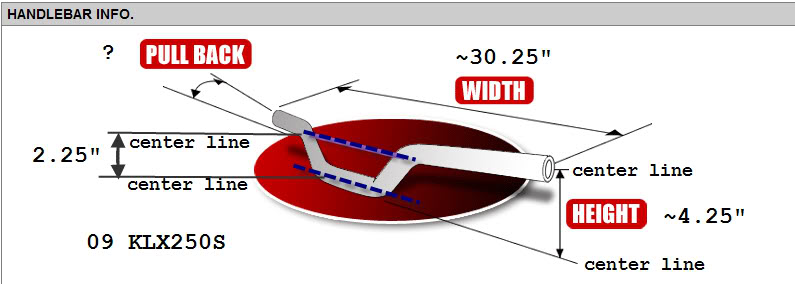

I atttempted to measure mine based on the Drawing...
Hmmm I must not quite have it yet.
Because at 4.25" mine are taller than the average CR High bend at 3.75"
I measured from the center to the center of the crossbar and that was 2.25"
I'll keep looking. A stock spec would shed some light if anybody has a spec.
Does the 1.125" bar taper back to the stock diameter or do you need new grips, mounts, etc etc etc.

Hey thanks for the excellent diagram! As for the 1.125 bar, it does go back to stock diameter.
