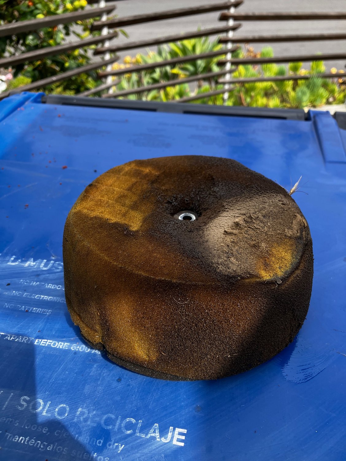

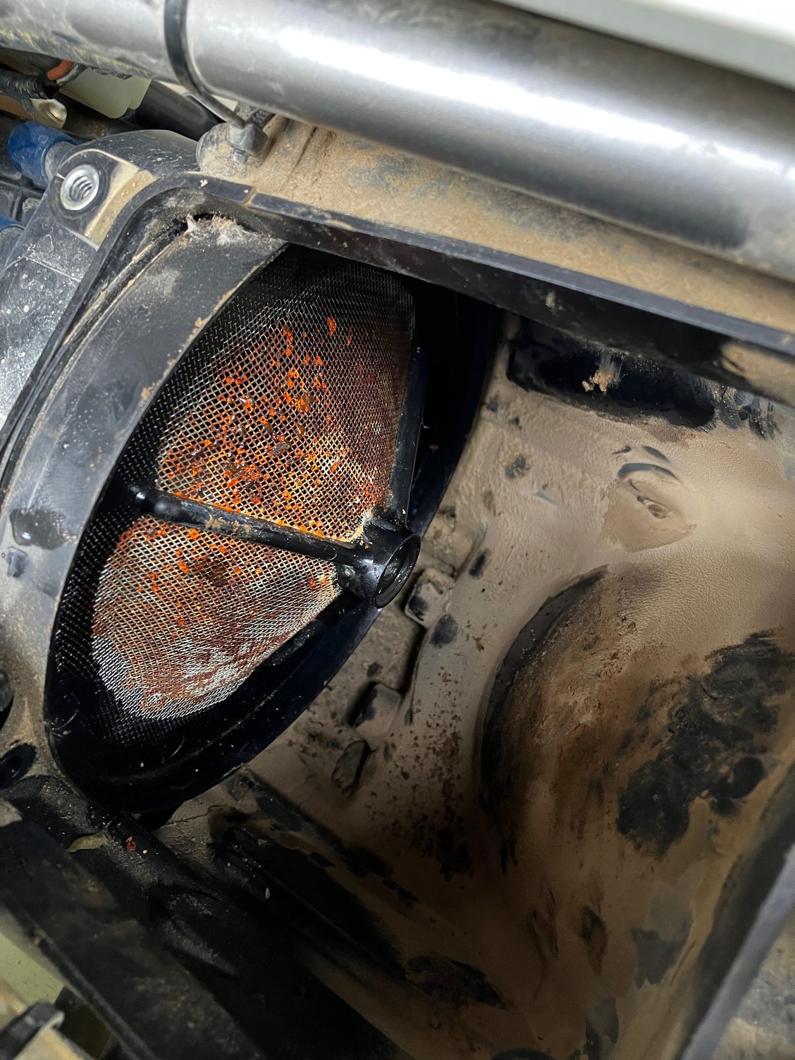

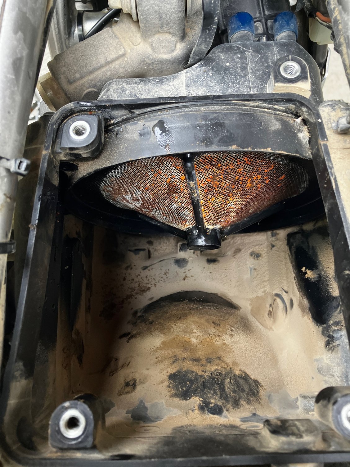

I deserved to be scolded! Running rich, even more so at altitude, no wonder! I had recently cleaned my filter, but hadn't realized my last four rides were so dusty.
The bike now seems to run fine; clean filter, slip-on exhaust, drilled slide, stock jetting. Dare I go to a larger idle jet for a bit more pop of idle?
