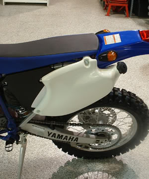

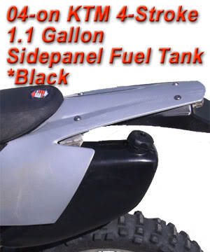

Interesting what's out there for other bikes.
I remember seeing an over fender universal aux tank somewhere.
Sort of saddled the rear fender like a saddle bag.
But haven't seen that design around for awhile.
