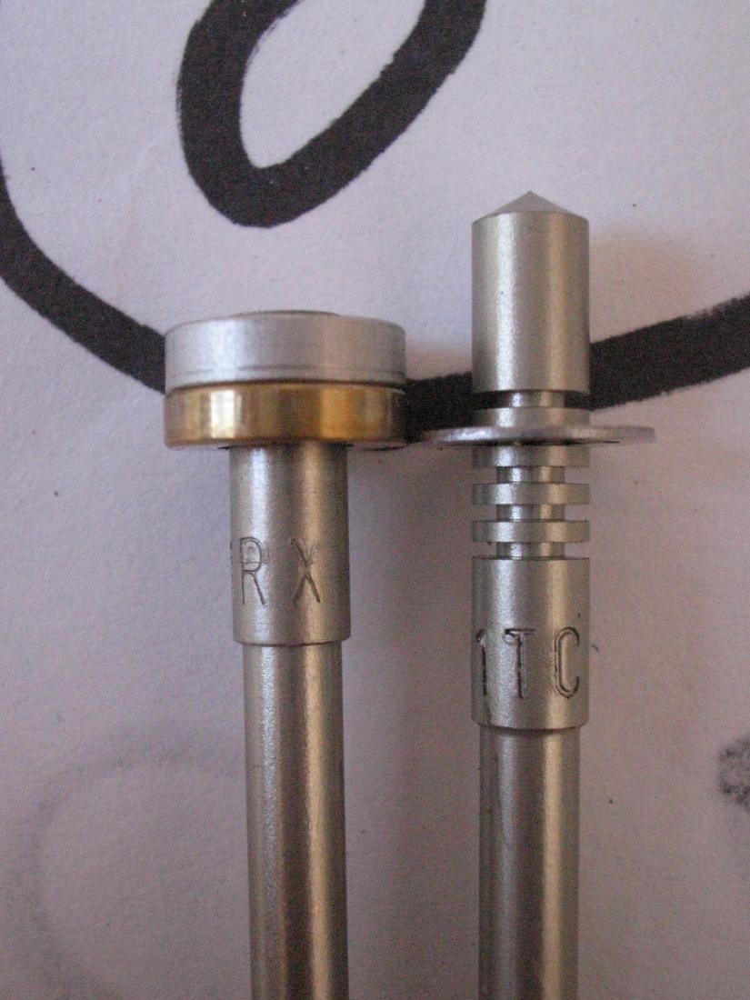

You pretty much running what the Kawa' service bulletin recommended for the 300 cc upgrade. #138 main, #38 pilot (you have the #40,) and needle raised. I recon' you'll not be far off the mark with that set up for the 351 cc kit. The CV carb' is very forgiving in regards to jetting. If you want to upgrade the main then I recon' a #142 (Keihin) should be a good start (with the stock N1RX needle.) Although you'll get a similar result with the N1TC needle and keeping the #138 main jet, it allows a fair bit more fuel through on the upper part of the taper compared to the stock N1RX. I've tried both and gone back to the N1RX as the bike was too rich with the N1TC and the #138 main. Mine is still 250 cc BTW, but I'm running the Kawa' service bulletin specs except for the jet needle mentioned (part #16017-1368.)
If it was me I'd go the N1TC needle and keep the #138 main jet and #40 pilot. When I ran the N1TC with the #138 main on my 07 250R, even on the top clip, leanest position, the needle was too rich for the bike. This makes me think there is plenty of room to add fuel to the main circuit with the N1TC needle as it has 6 more (richer positions.)
I got my needle from these guys . (Needle N1TC part number is #16009-1912, Clip part # 92037-1401, Collar part # 92143-1677) >>> Welcome to Mototech Motorcycle Technology

This gives the idea.
