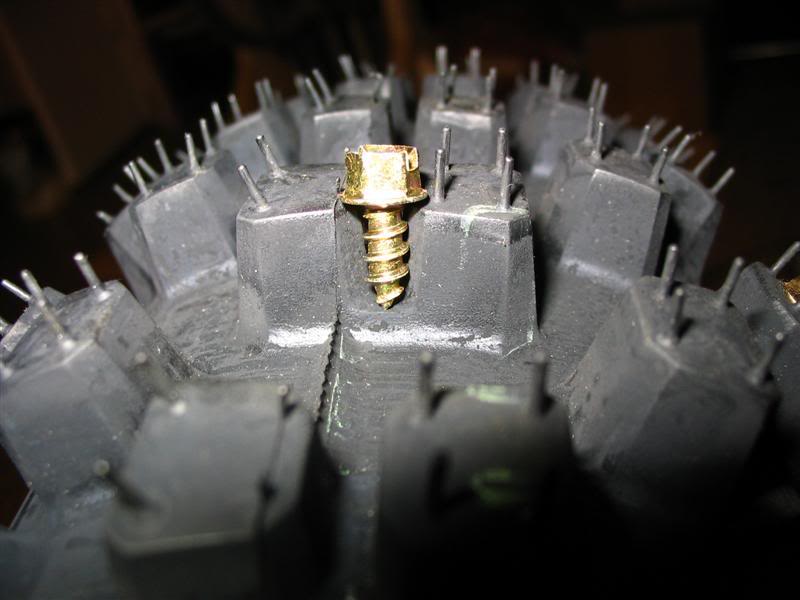

Pics are below. My spokes didn't show up today so I couldn't mount the tires but I figured I show some pics of the new meats and studs.
Here's a shot of the rear tire **** height. Measured its a full 11/16" tall. That is a 7/16" shank Pro Gold ice screw hanging in the middle. Offroad only ***** are MEATY!

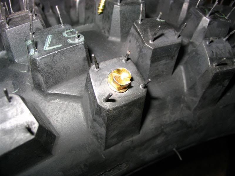

Stud in rear shoulder ****. Studs take a quarter inch nut driver to install, heads are 3/16" tall, compare the size of that, to the *****.
Front tire with stud hanging in the middle. The front ***** are 9/16" tall.
Pic is kinda blurry as I didn't use the flash. I was trying to show the head profile of the screws. They have a standard hex head that is dished and slotted. The edges are literally sharp, not knife sharp but uncomfortable if you grab the tire and thats in your palm.
The carcass and sidewall on both tires are 3 ply and are rated up to 80mph, but are offroad only. Honestly I wouldn't want to take these on the pavement with the **** spacing they have. To connect trails is one thing but I wouldn't do a lengthy DS with them like I did the TM's or AC-10's.

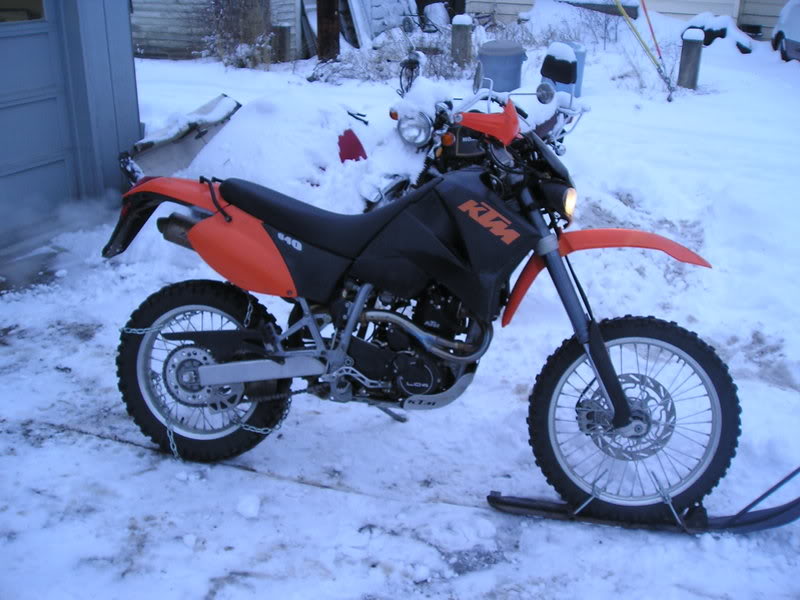

Looks Tippy.
