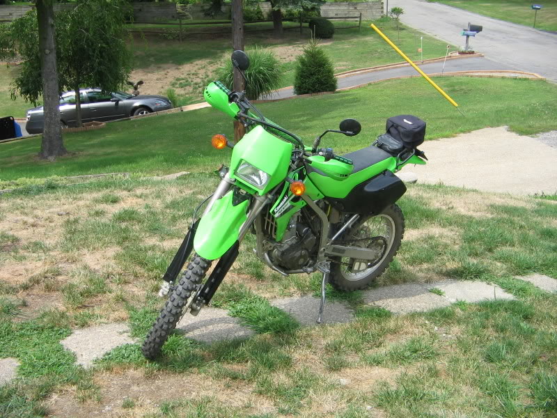

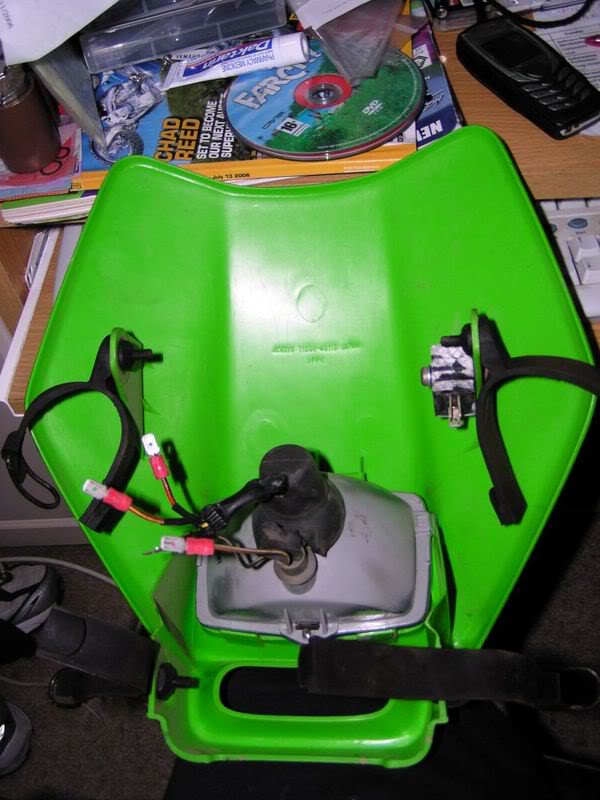

ORIGINAL: double d6
I have the shroud off and all the metal guts are bent real bad..........Do these after market headlight assemblies go over all that junk?
Can I use my 55w bulb with any of the aftermarkets?
This really sucks man.............................
You take off all the metal junk and replace it with a nice lightweight headlight unit that straps to the forks with rubber bands. If you look at the pic of the headlight I showed you in the other forum about your headlight you will see the rubber bands. Once again if you don't use the light much it's ideal. The aftermarket ones are not as bright as the stock due to a lower rated bulband it may be the case the aim may not be perfect. Mine does have an adjusting screw for headlight aim but mine is a genuine Kawasaki unit. I don't think you can use the 55w in the aftermarket ones I think it would be to hot and melt / damage the plastic.
