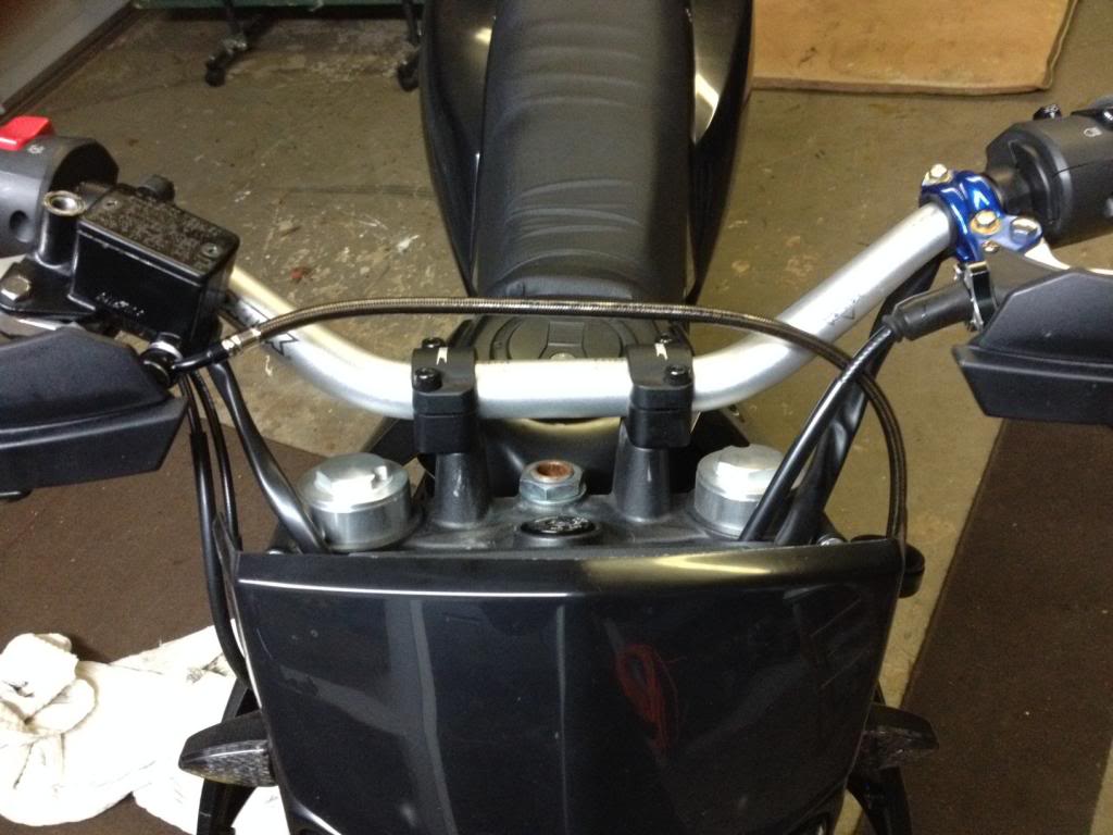

Just finished installing a custom front brake line from Galfer. 52" carbon smoke color. The stock line got damaged on the brake rotor.
The line was to small and wanted to slide out of the original guide. Small piece of black tubing cut and wedged in there is holding it nice and tight.
