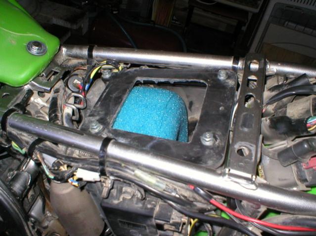

I don't know...I don't have an issue with my airbox lid noise, but I did something a little different. Maybe mine isn't as loud because I just opened the original hole a bit more while leaving some of the edges of the original lid. Perhaps this allows the sound waves to bounce around a bit more which may damp the sound a bit more. I don't run the snorkle.
Why didnt you just remove it? Thats a BIG hole... i cant see that flowing less than removing the lid entirely.
Yes, a big hole...but...I think it still helps with some of that droning noise and water and debris will still have a harder time getting in with the seat on. With the lid completely off, it's kind of like a big, open, empty, coffee can...easier for things to fall or pour in...also maybe more of a megaphone for sound. This opening is more akin to a large bottle with a necked down opening. More airflow than stock and probably more area than absolutely needed, but the lid still probably aids sound resonance and can't hurt with water trying to lap/spash in. Nope...no dyno charts, no NASA decibel tests, and no U.S. Navy submarine testing...but it didn't cost anything.
