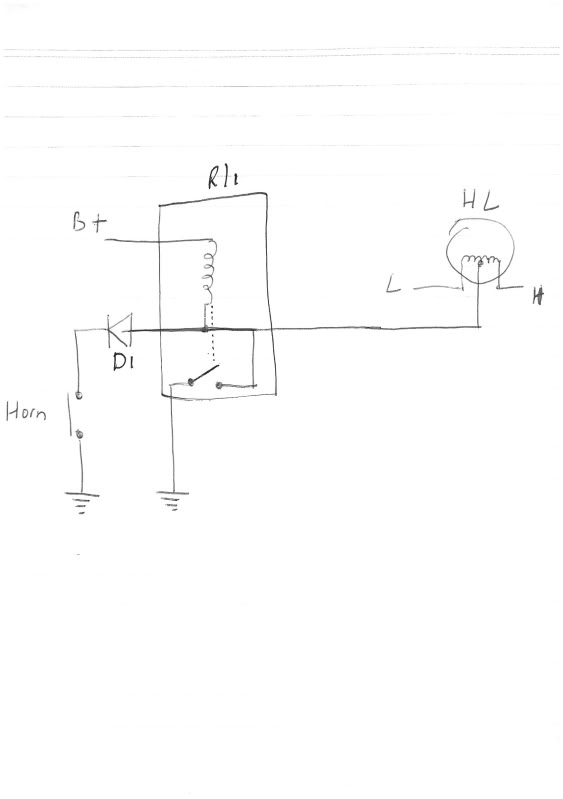

Is it that simple?
If I trace the common earth from the H4 globe back some, (I assume there are three wires into the globe, 1 live for low, 1 live for high, and the common earth,) then cut the wire and install a simple switch inline, I'll get the desired effect. The ability the turn off both low and high beam at will. Gives me the option to start the bike without the lights running when the switch is in the off position.
Yep, its that simple.

I over complicated the latch circuit a bit.
If you use the earth return from the headlight as the switching point, then this will do it.
+1 ...........Nope, this is how I would do it. No new holes to drill with an unsightly switch mounted in already limited space. Making a current switch do double duty is great!

No offense roadglider but when most people see a wiring diagram they run for the hills! Once you understand what the symbols are for in the diagrams and the basics of what a diode, resistor, relay, latching relay and a couple of others things do you got it made!

Neil's idea is a good one though if you want the light off to start with.
