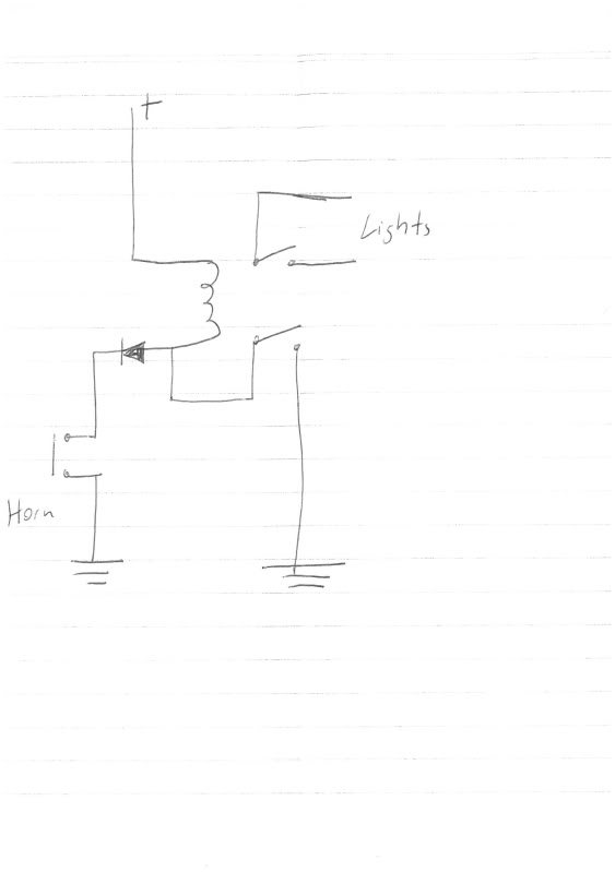

Objective - To disable the headlight until the bike is running and the light is to be switched on using only the standard controls.
Method - 1 double poled relay and 1 diode wired like this. $8 max.
(sorry for the hastie hand drawing)
Result - The light will remain off until a quick touch of the horn.
So, you jump on and turn the ignition on. The headlight will remain off until the relay is energised by pressing the horn button. Then the relay will latch on using its own contacts. The other contacts will operate the lights. The diode will isolate the horn when the relay is latched.
Its an idea.

great idea on the relay latch.
THe fuse thing is a hassle if you ant to flick the light on in an instant.
I just pit a switch on the ground on a DRZ I had. Been meaning to do it on the KLX, but not there yet.

I agree, switching the earth return wire is the way to go.
All stays up the front end.
My latch idea just negates the need to mount a switch.
