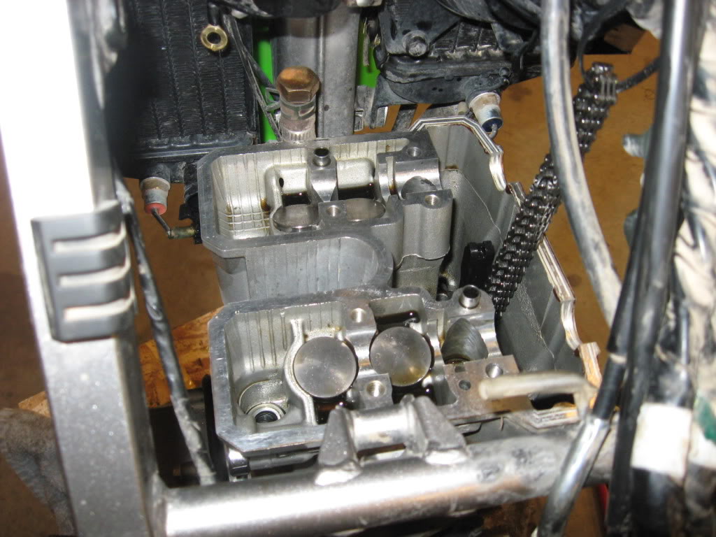

LATE EDIT: CHECK VALVE CLEARANCE BEFORE REMOVING CAMS.

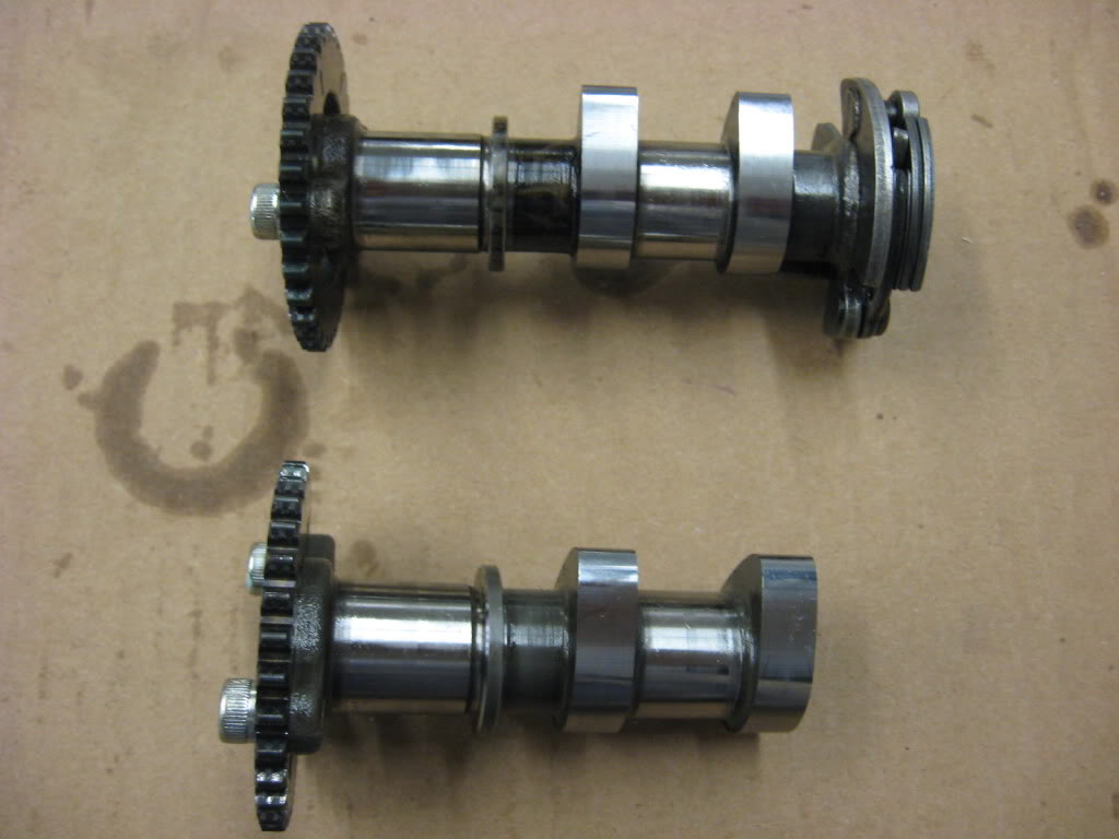

Cams. Need to check tolerances.

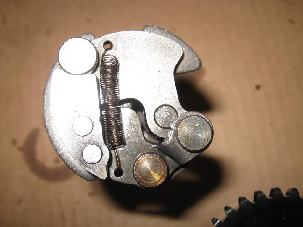

ACR Side

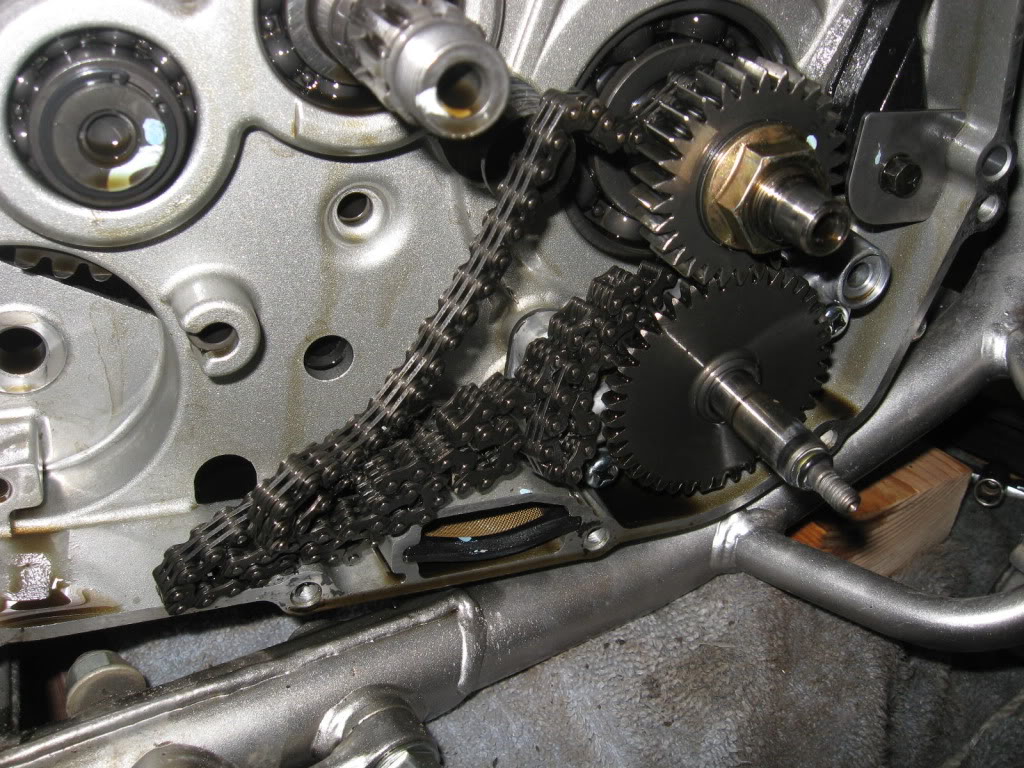

Keep the chain from falling through...maybe
Or, just open the bottom end cover and don't worry about it.

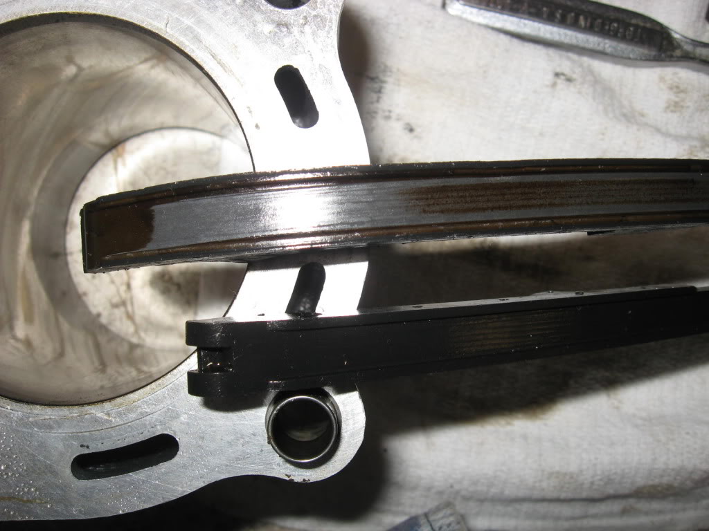

Sliders look okay to me.

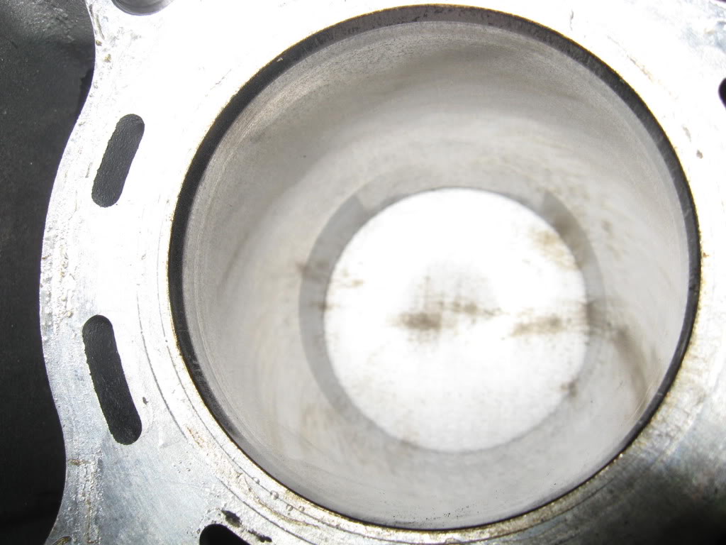

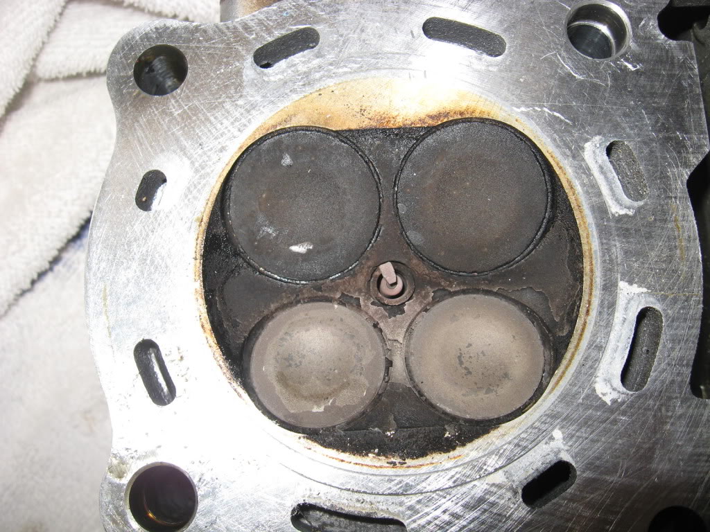

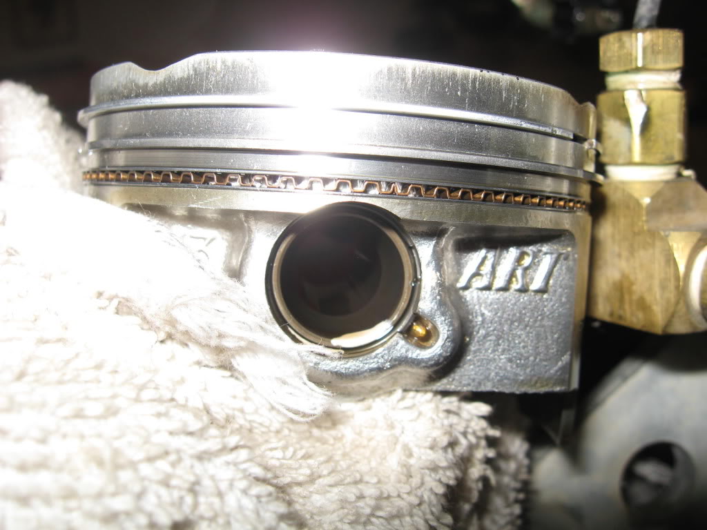

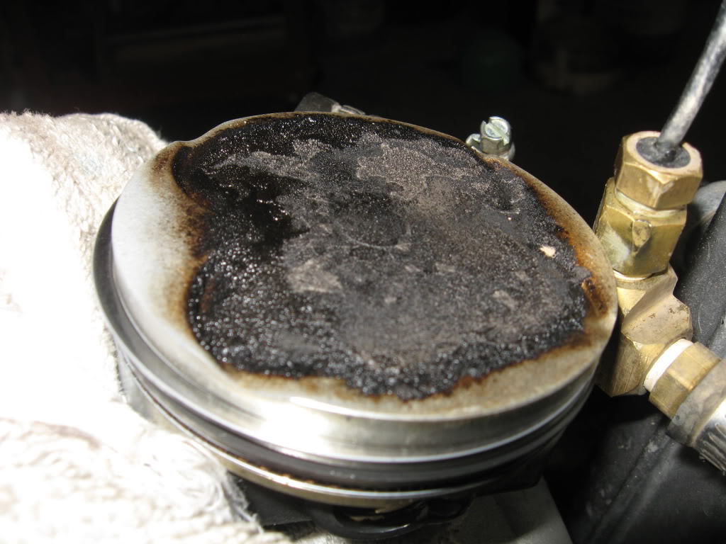

More buildup on the piston than I've seen in other pics. Rich?

Is it worth trying to index the spark plug so the spark front faces the intake?

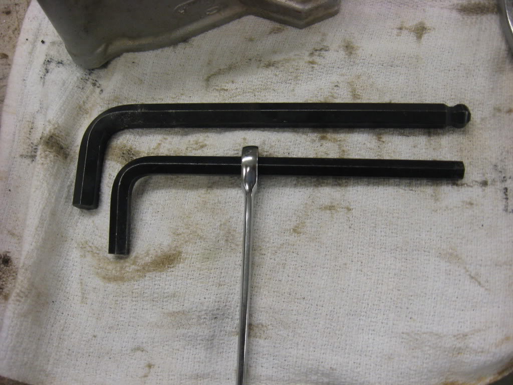

Here's a swell setup for removing the head bolts using a ratcheting unit on the hex wrench.
