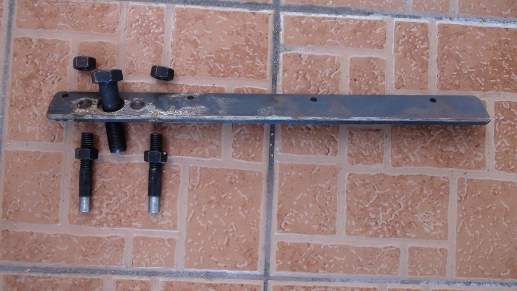

Here's the tool I had made up to pull/install the flywheel
Big center bolt to coax the flywheel out with the turned down 9/16 bolts going into the flywheel itself. Cost me maybe $15 incl the bolts
It worked great!
