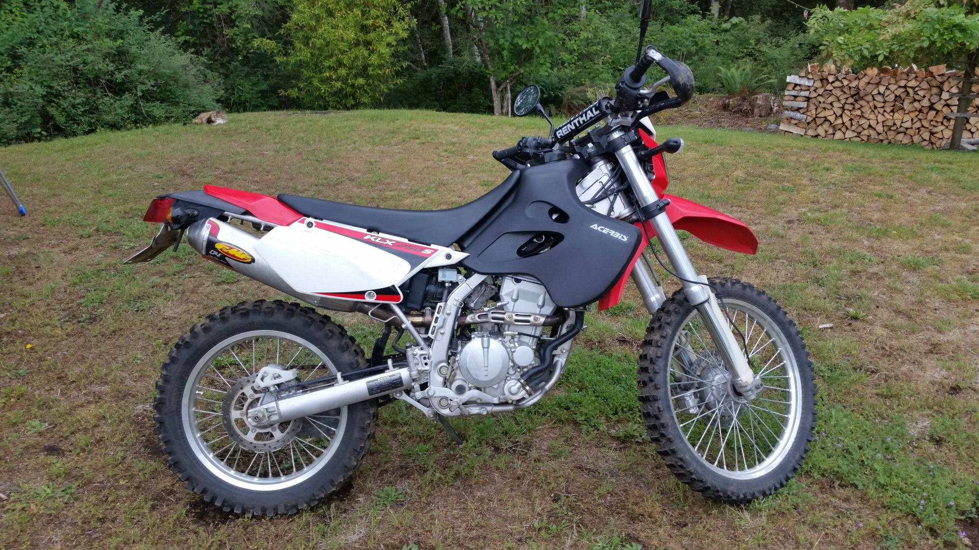

Here is a picture of the loose fitting I just did:
At least the black tank on red bike looks a lot better than the green tank on green bike. At least in my opinion it does.
