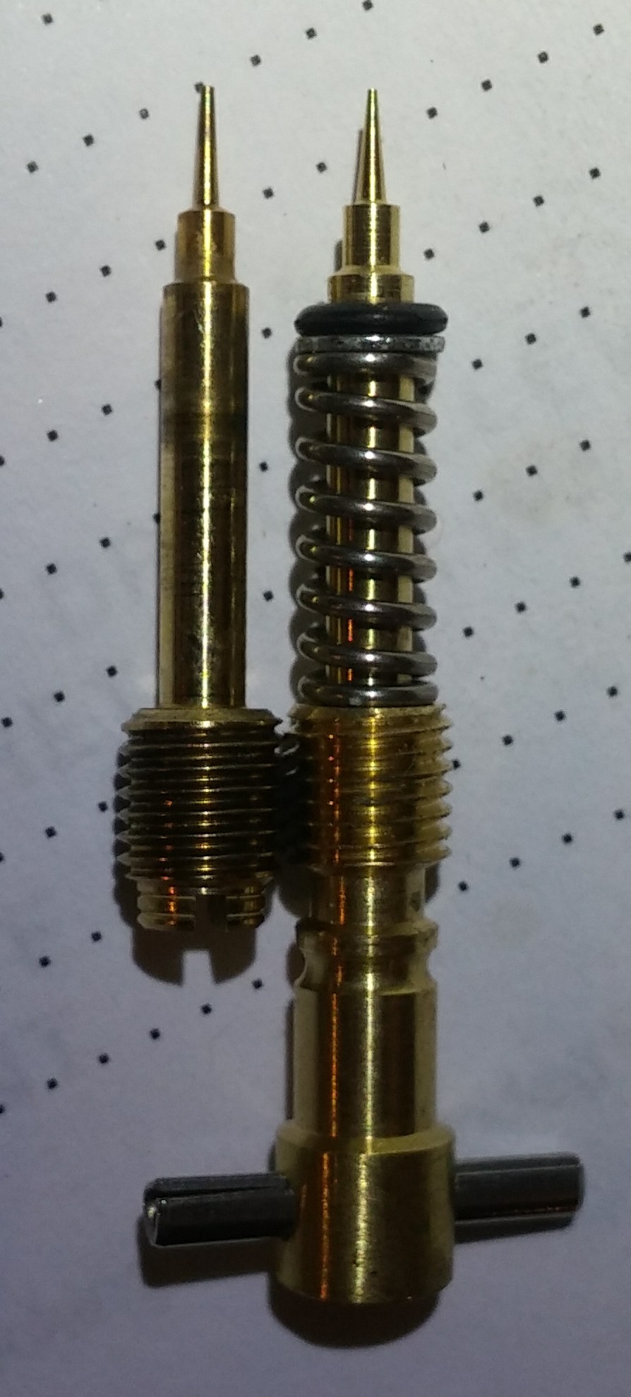

Midway between idle drops also happened to be my highest idle point @ 1 turn out.
Well my good sir... as far as the taper you are in luck, I took a photo of them side by side and they are slightly different, the Kuoba having more of a triangle shallower taper and possibly a finer point, to my eye anyway. Pic attached.

I thot the Kouba was different from stock.. Explains why you are "good" at 1 out vs more like 2 out for the stock fuel screw..
