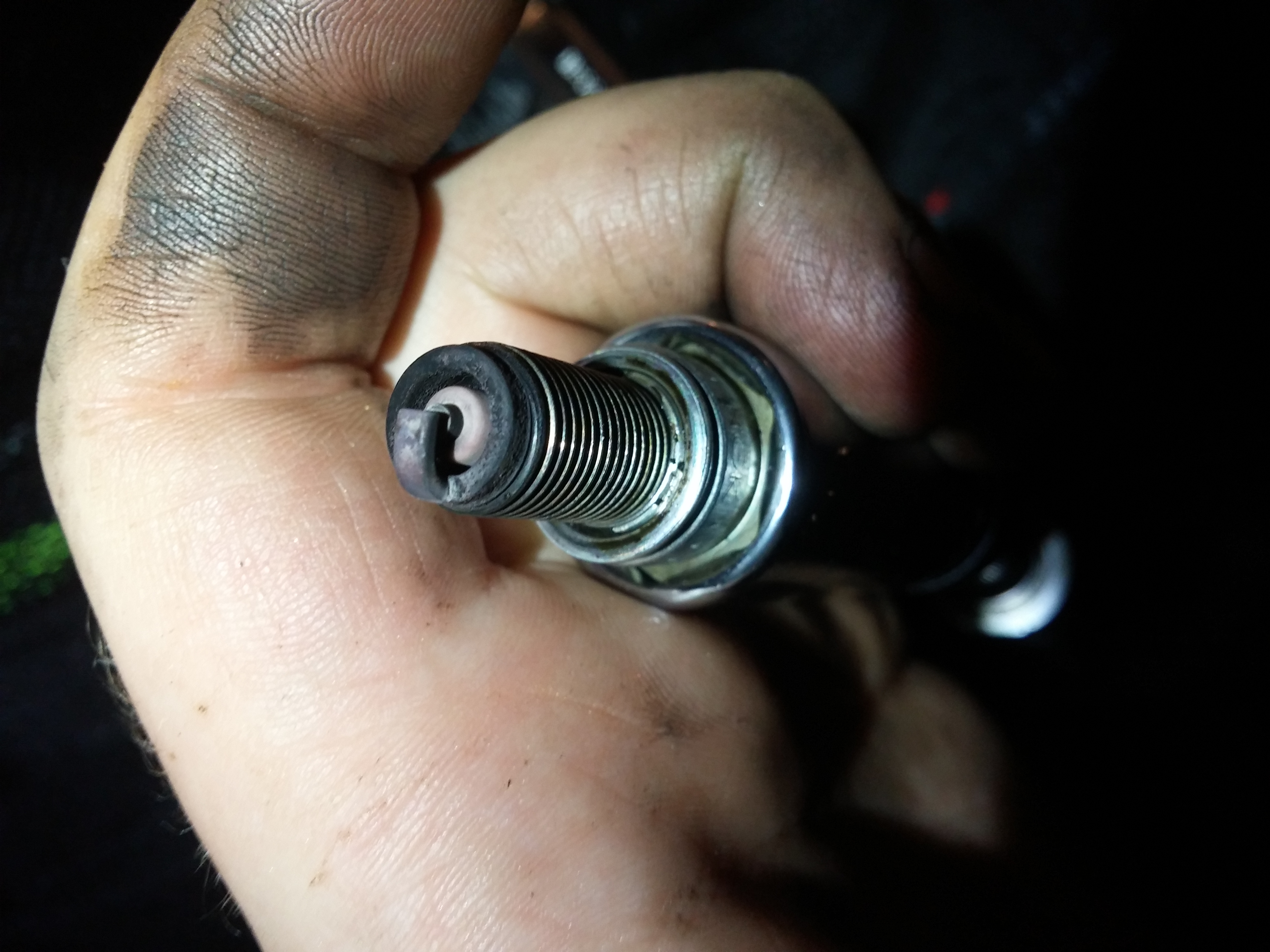

Here's my plug after 300 miles on 144/1N, looks lean to me, I am putting in my 146 asap because that's all I have left, need not order more jets on Tuesday, what do you all think

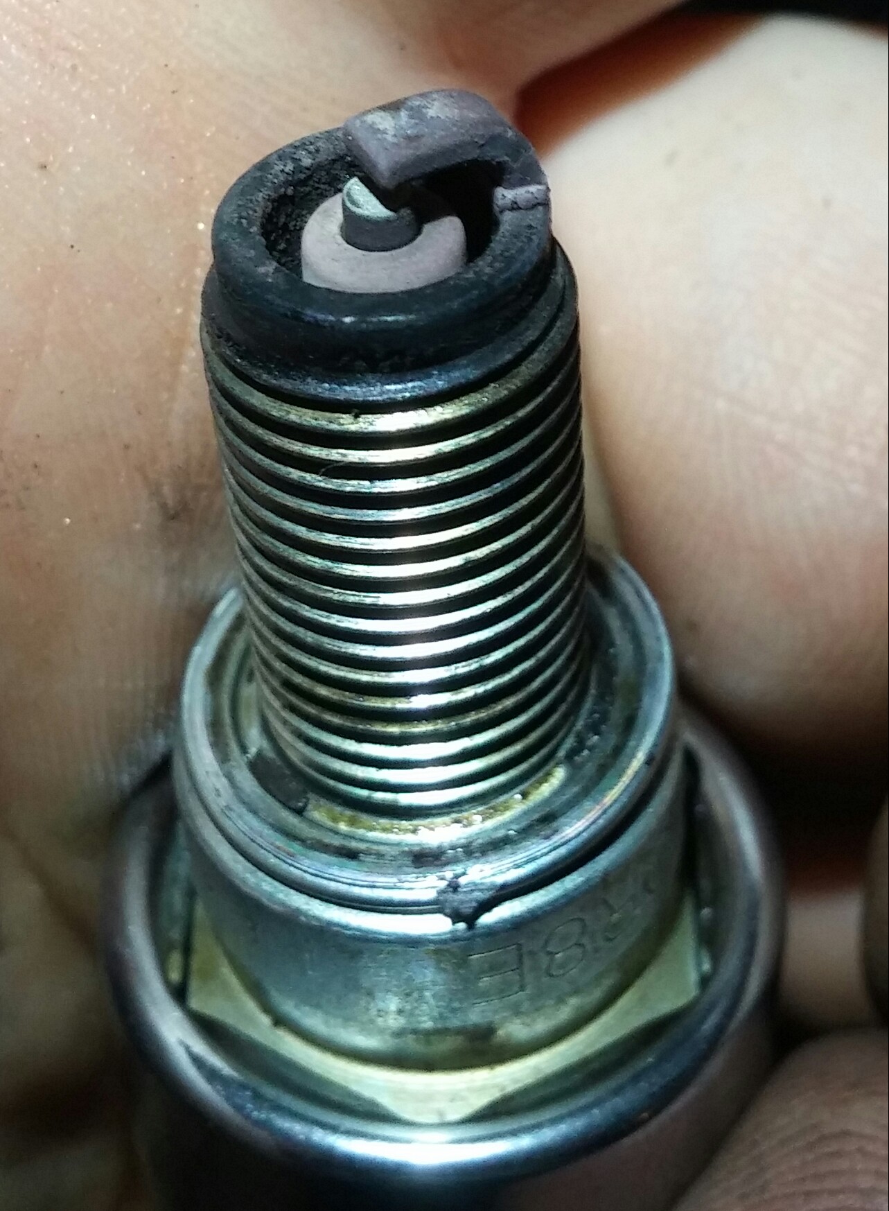

Here's a better one, I guess it doesn't look too awful...
I also noticed the too if my piston is already brown/black with some light deposits, is that normal for 300 miles? Can't get my horoscope working till Tuesday.
Let me know what you think about 144 vs 146, I'll have it apart for a bit.

All times are GMT. The time now is 07:26 PM.
