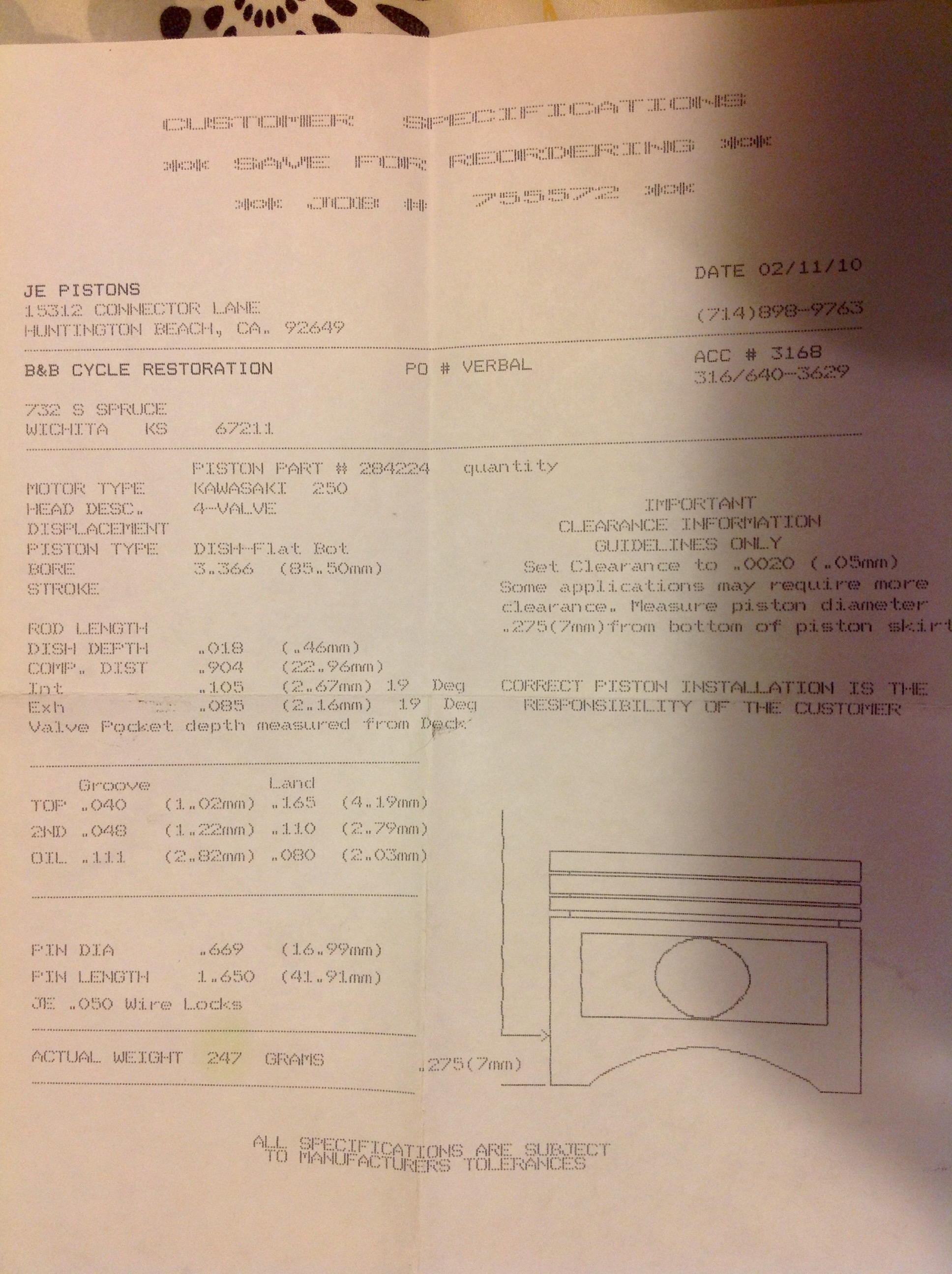

Specification sheet for big bore JE piston kit.
Thank you B&B Cycle the kit I received is running stronger than ever
