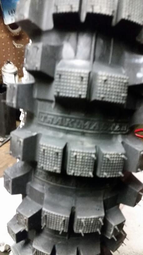

I have a stable of 4 stroke and 2 stroke racing bikes and have owned all make and manner of offroad and dual sport bikes.. Once upon a time, long ago, my KDX200 "playbike" was the most popular of all... Anyway, I have a suggestion. The KLX is an offroad bike with turn signals. It only varies from the "real thing" due to the "50/50" tires your running. Put a good set of offroad only tires on the bike and feel the new capabilities.. It will become a surefooted rut-eating woods bike.. Once re-tired, the extra few pounds the bike carries will be a net advantage in offroad handling in many senarios.. Choose the aggressive DOT 90/10 offroaders and stay legal for the "hoods" as well..
While aggressive DOT off road tires will take you to "next level" off road, they do not provide the grip on the street for aggressive "hooning" especially when the pavement is wet .. So keep it to putt putt-ing on the road..ok?

A DOT knobby type tire and a 351 kit would go along way towards making the KLX a monster. You can pull the signals and add a lith ion battery for some weight savings and still have it plated for the street. Off roading is a blast but you will get tired riding the same trails over and over so unless you have a truck to haul a dirt bike to some new areas I'd keep a dual sport. Jumping isn't an issue for the KLX it can go as far as you can.
