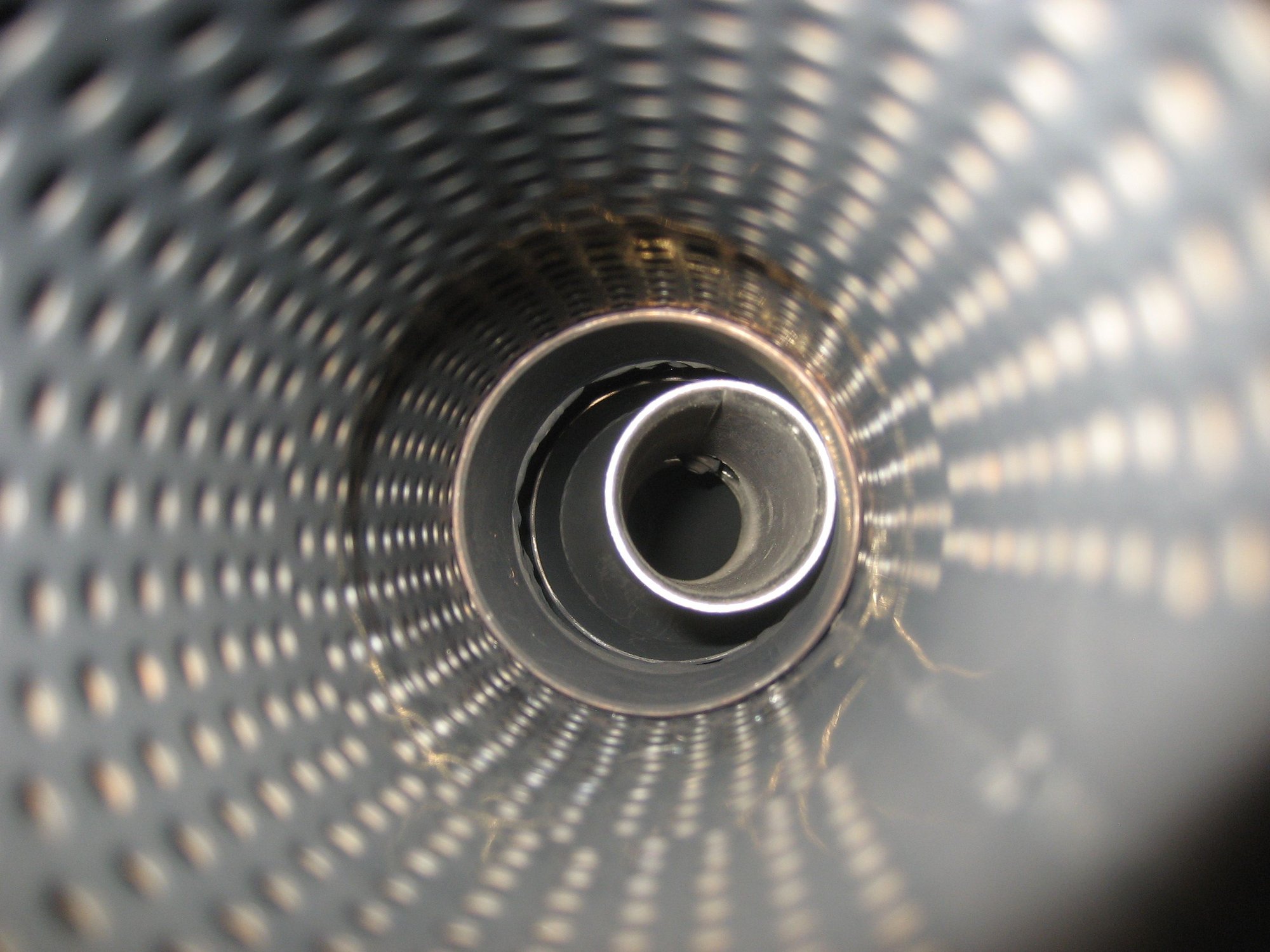

I also share your interest and am also considering the mcm mod. I did a couple of other mods on my KLX to increase low rpm torque. One is a FMF Megabomb header...
And the other mod is extending the length of the midpipe about 6 inches into the muffler.
And an oversized intake...
I live in a rural area and ride for daily utility transportation so my engine runs at partial throttle in the 3,500 to 5,000 rpm range all the time. It pulls strong at 3,500 rpms without lugging even with small 37T rear sprocket road gearing. These parameters are well within closed loop fuel management so the O2 sensor works fine and I'm not experiencing any lean air/fuel ratio symptoms.

The stock muffler weighs a hefty 8 pounds 12 ounces, whereas mine weighs only 3 pounds 6 ounces. Removing over five and a quarter pounds of weight from high on the chassis makes the bike feel less top heavy.
