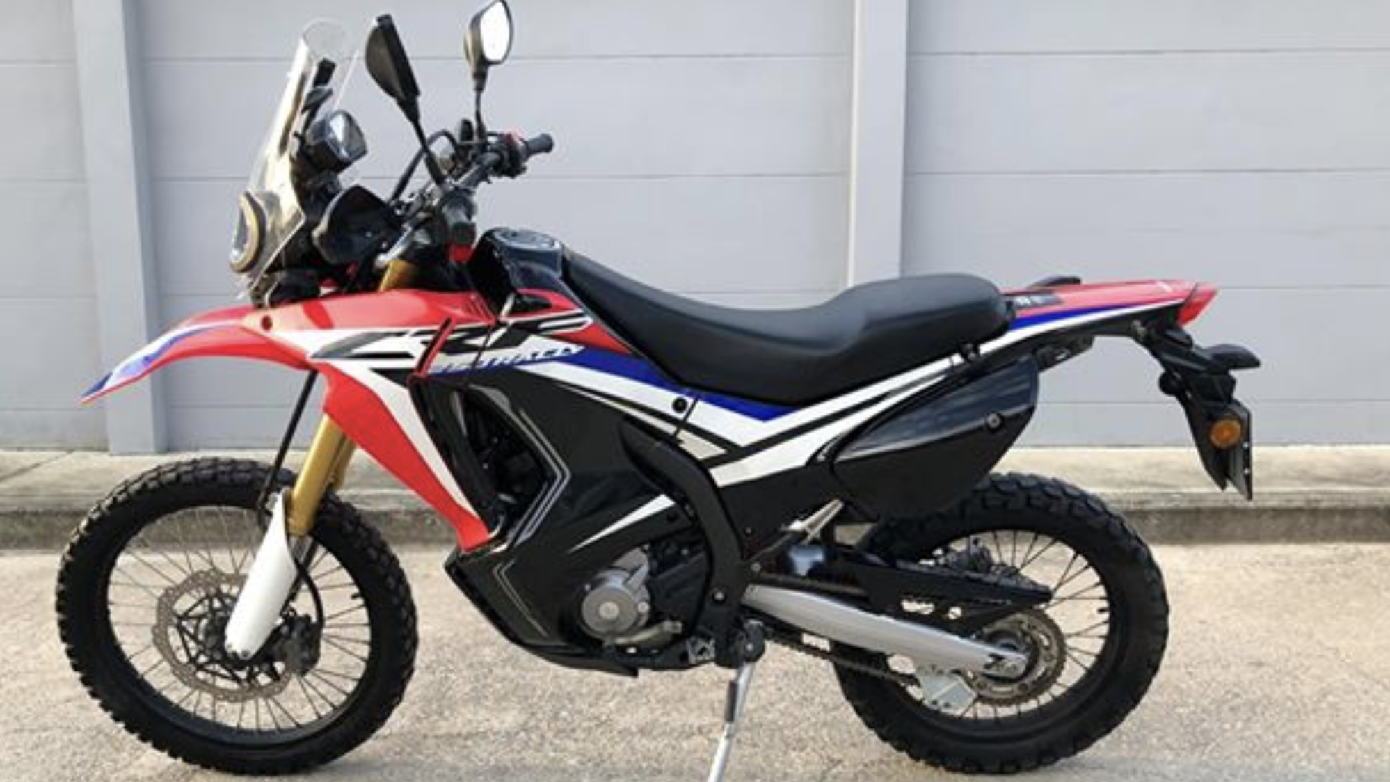

I’m about to refoam my stock seat to make it more Tour-friendly. Plan is to add a bump on the back and make the middle softer. Anybody got experience with that? Is it advisable to cut away the stock foam or just add a soft foam layer on top?
Example foto

You don't want that profile of the Rally seat you show there. You want flat in the rider area, not cupped either to the front or to the rear. Make it so you can move around. The step in the back makes sense both if you have a passenger or you want to put some throw over bags. I want to step the seat on both my KLXs, but haven't done either yet.
Best thing to make a saddle feel softer is to ride more and get your butt used to it. You could have a jell pad implanted into the seat when upholstered. The other thing is some widen the seat where you sit, distributing weight better. Someone will post about it I'm sure.
