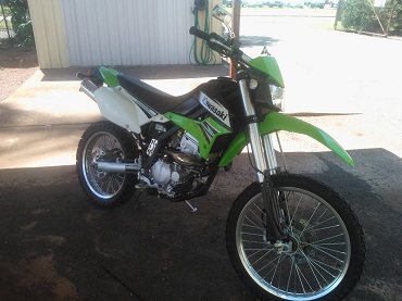

Hi guys, thanks so far for your responses. Thought I would upload a couple of pics of the big girl as she sits at the moment.
