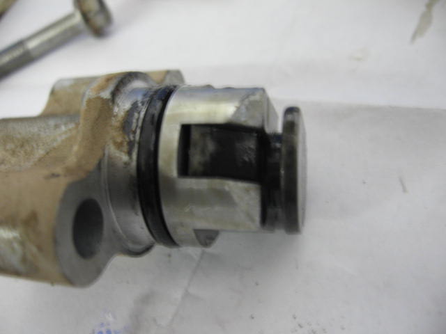

Important: tensioner must be reset. Lift up on the locking pawl (yellow arrow)) and push the tensioner rod fully in. Now it should now look like this:

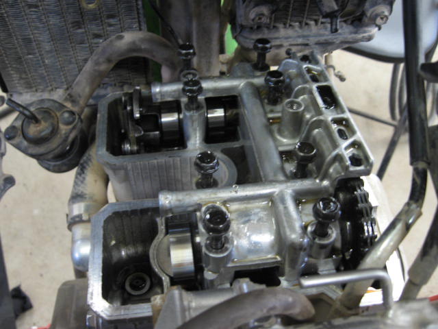

Now comes the harder part: OK... so now we have to remove the camshaft cover. In the next pic you can see all 8 bolts loosened.

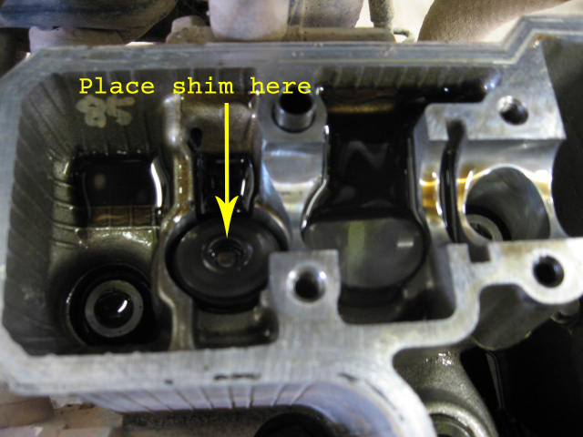

After removing bolts, cover can be removed. Next it would be a good idea to tie the timing chain off to some part of the bike to keep it from falling way down into the engine. Now you can remove the exhaust cam (if doing exh clearances). To remove cam its sorta of a tilt/tip/lift process. Thats about the only way I can explain it. With cam removed you can now take up one of the lifters. Only do one at a time to avoid mixing of parts. In the next pic you can see the valve spring where the shim sits once the lifter is removed. To the right you can see the other lifter still in place.

Measure this shim with the micrometers to figure out what shim is required to put back in. Place new shim on top of valve as indicated in a previous picture. Then place lifter back in place. Repeat for any other lifters/shims.
