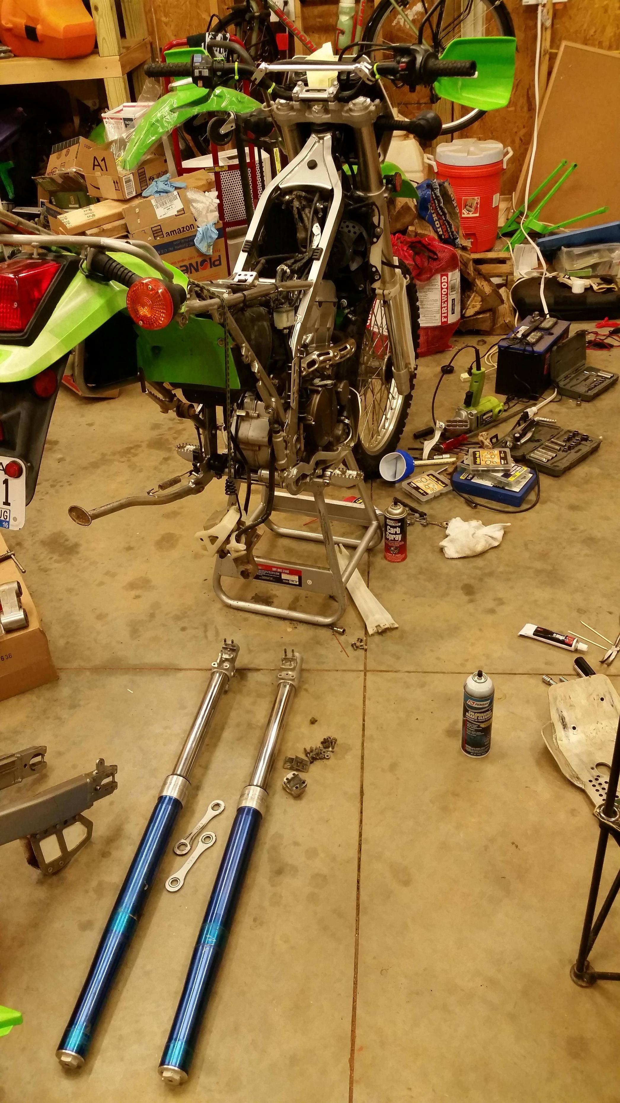

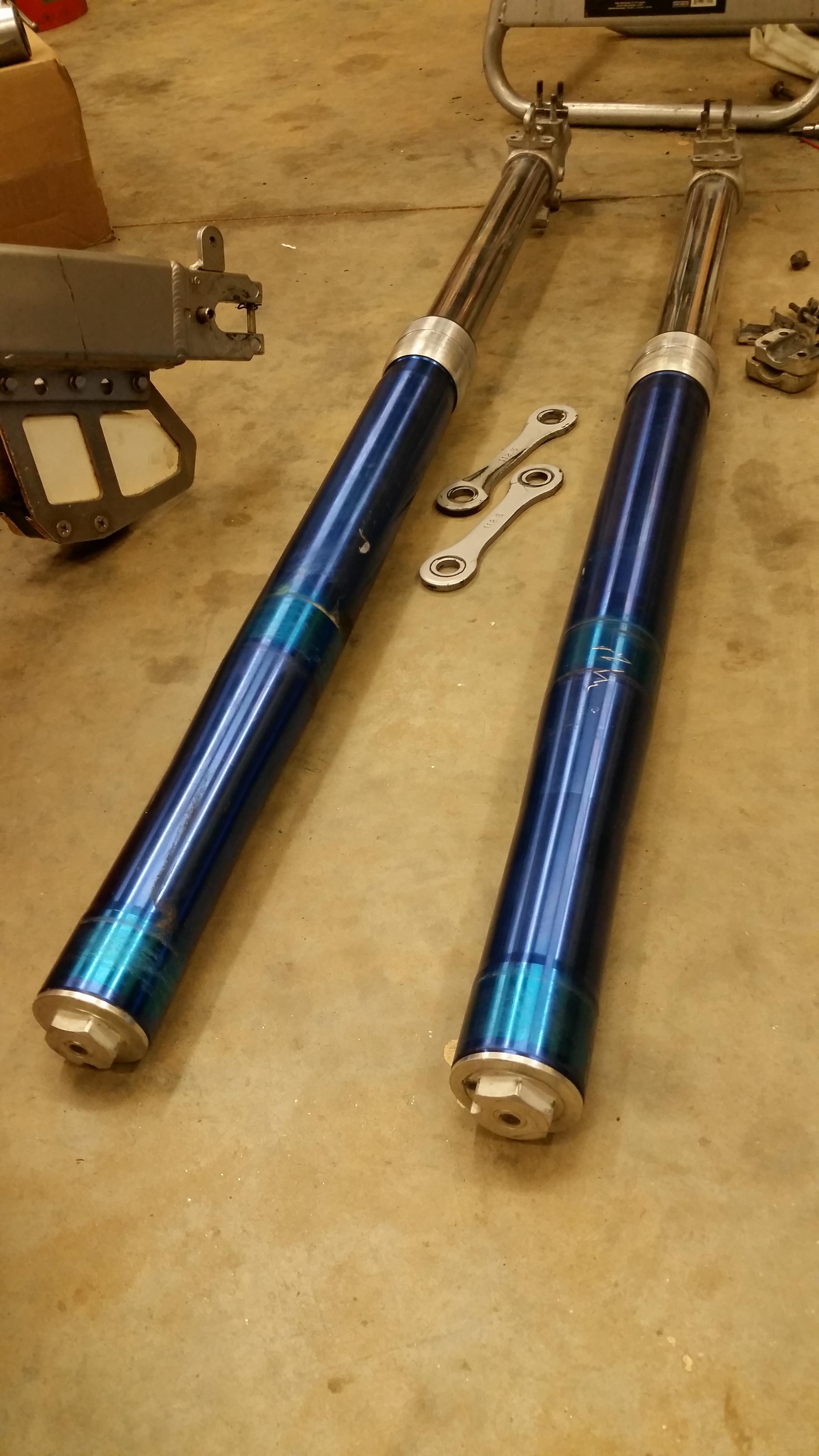

93 fork legs arrived. Anyone have a source for the cartridge holder tool?

I'll try running the 112.5mm KDX pull rods to even out the ride.

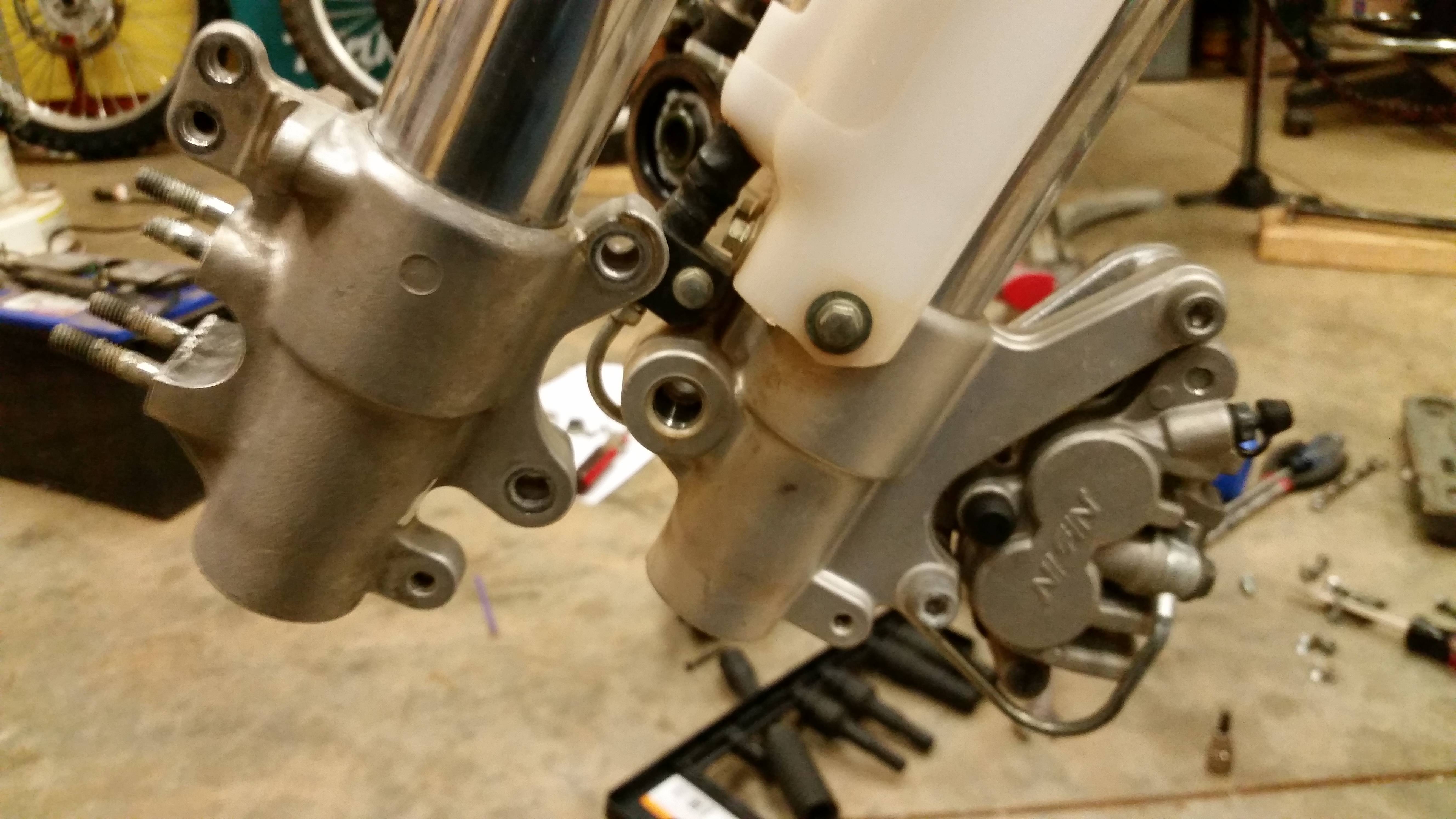

Quick follow up. The 93 tube bottoms are not a direct match. The brake side is different
1) caliper mount holes on the 93 forks are about 1" closer together
2) has identical axle mounting setup as the 07 right side fork (cap with four 6mm nuts). I would need a 93 axle assuming the length is right.
The biggest obstacle is the caliper mount which looks not compatible.

Ok I forgot that the axle adapter is available (or plans to make your own).
That leaves the brake caliper mount. The KLX300R / 93 KX250 fork swap page just says to use the KLX300R caliper. Clearly the KLX250S won't fit (see pic above).

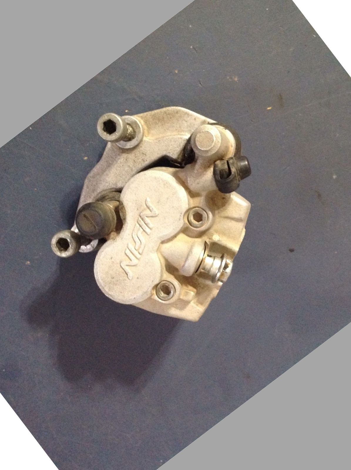

Here's a 93 KX250 brake caliper, more or less rotated to the correct position:
