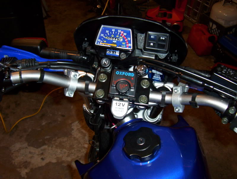

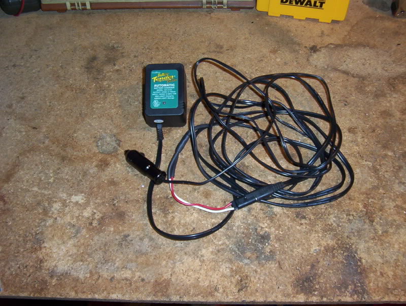

Oh dude you gotta invest in a battery tender, I use on on both bikes and it really does double the life of the battery. I also wired in a 12v plug on both of my bikes and so I can charge the batteries, run a cell phone charger or charge between bikes using my patented cord.
Here are a few pics.

No more fumbling with taking off the battery covers, just plug and go. Oh and jumping a dead battery can zap the life out of an alternator. Its always a better choice if you can charge it on a slower rate over a longer period of time.
