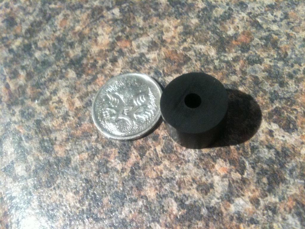

Old Jul 15, 2013 | 11:27 PM

Took the restricter out of the 2010 Aus spec klx250.
