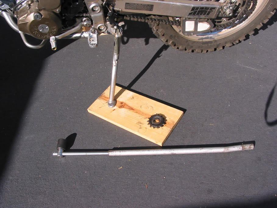

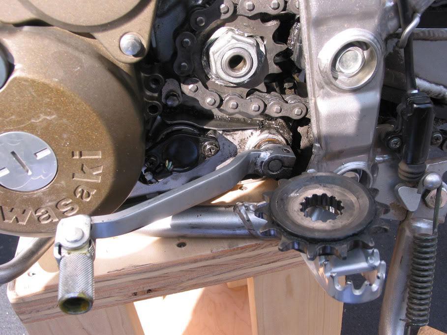

Zee sprocket from a Honda XR 650 L on to my KLX...
Just can't seem to change anything out on the bike without running into two fangs!
