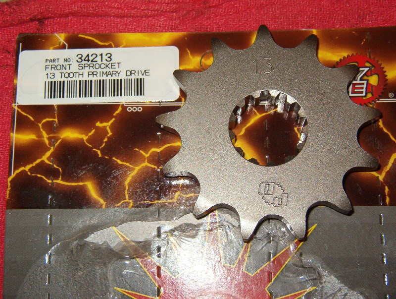

Got it from RockyMntATV.
Well, "ain't that special??"
But, Sail-A-Way, didn't you say that you had the #34213 part ..... and that Rocky Mountain didn't have one ... ? I'm 'gonna stay glued to this thread 'cause I've just got too see how this is finalized!!! Cliffsta said that is where he got his 13T CS.... didn't he?

PD = Primary Drive.
http://www.rockymountainmc.com/produ...#vehicleSelect
The part is for a 07 but it fits the 09, like 09KLX said, "they are the same down there".
*Sigh*
Ok, let me repeat my self.
I have an 09 KLX 250S.
This is what I ordered through the dealer catalog
http://sunstar-mc.com/searchresults.aspx?ProdNum=34213
I had the dealer install it for me. It took 30 minutes at about $50.
The countershaft sprocket in that link works for an 09 KLX 250s GREEN
....may not work for the red ones. ;P

No, I put a 14-tooth replacement on the bike, but I ordered for the XR650L because RMATV didn't list the stock 14 for our bikes. My gearing is 14/47.
However, I now see they offer a Renthal stock replacement 14 tooth for 21.99. Huh. They didn't have that a month ago.
And to clear up some of the other confusioni: A month ago, RMATV listed the PrimaryDrive front sprocket for the 09 KLX250 in 11/12/13 tooth sizes, but not the stock 14. NOW, they do not list the PrimaryDrive front sprocket for the KLX.
RMATV does not list a 13-tooth countershaft sprocket for the '09 at the moment.
MotorcycleSuperstore lists the AFAM 13-tooth for the XR650L as unavailable at the moment.
Very interesting. Apparently everybody bought 13-tooths at the same time LOL
I hope that cleared some things up, sorry if I added to the confusion.
